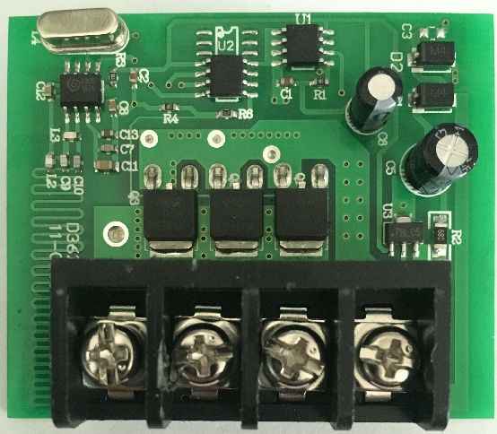

I just bought this controller by AliX And it works great under Domoticz when you learn each remote button as a on/off switch.
http://nl.aliexpress.com/item/DC12V-24V ... 57510.html
But i like it to use as a dimmer with a slider so i can make a blockly to set the brightnes, is this possibele?
