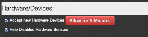

I tried to pari my OWL CM180i (Micro +) to domoticz but it fails and everything was good:
- Oregon protocol enabled (cf attachment)
- new hardware enable in settings (cf attachment)
Any clue about what i'm doing wrong?
Thank a lot for any help

Re: OWL CM180 paring issue
Should be working with these settings. Are the batteries empty or the distance between the owl and the rfxcom transceiver to big?
