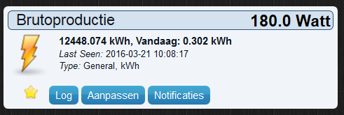

Yes,
I send the information to Domoticz with
http://'+domoticzserver+'/json.htm?type=command&param=udevice&idx=86&svalue='+power_used_con_str+';'+power_used_num.
Here is my code.
I know the script can be much beter. And I have to learn a lot.
But that is just the fun of it

domoticzurl1 = 'http://'+domoticzserver+'/json.htm?type=command&param=udevice&idx=86&svalue='+power_used_con_str+';'+power_used_num
domoticzurl2 = 'http://'+domoticzserver+'/json.htm?type=command&param=udevice&idx=87&svalue='+power_delivered_con_str+';'+power_delivered_num
domoticzurl3 = 'http://192.168.10.30/json.htm?type=command&param=udevice&idx=6&svalue='+power_used_num
domoticzurl4 = 'http://192.168.10.30/json.htm?type=command&param=udevice&idx=87&svalue='+power_delivered_num
# Domoticz prod
req = urllib.request.urlopen(domoticzurl1)
html1 = req.read()
print (html1)
req = urllib.request.urlopen(domoticzurl2)
html2 = req.read()
print (html2)

I used Jossie67's script to push data from my ISKRA ME162 "bruto productiemeter" (which is only measuring my solar output), read with an optical probe bought at http://www.smartmeterdashboard.nl/webshop , "IR Converter Cable", to my domoticz server running on my Pi. I did this:
  • Setup - hardware - create new "dummy" device
  • Setup - hardware: at the new dummy device: create virtual sensors: Type "Electric: instant + counter"
  • Setup - devices: check which Idx the new device has (for instance, 15)
I then adapted Jossie67's script with the following main differences:
  • use ttyUSB1
  • use my own temp dir
  • use output line 2.8.2 and don't add a zero
  • use only the power_delivered variables
  • use localhost:8080 as domoticz server
  • use idx 15 as my dummy "Electric (instant + counter)" device in the "Send to domoticz" URL
Also, I used a soft link from /home/pietje/bpmeter to /run/bpmeter to be nice to the SD card in the Pi. This because the /run dir is in ramdisk and therefore it doesn't wear out the SD card by constantly writing to the same file again and again.

As a last thing I set to zero the lines with the very high values from the meter_calendar table from domoticz.db, (the values representing the current value), because otherwise these values would dwarf the next measured values and you won't see any detail about them. I stopped the domoticz server, used a sqlite editor to remove the values, saved the database and started domoticz again. Now my measurements start at 0, but I still have a value for the total. My measurements started last Friday night.
Graph:
http://imgur.com/cUTUapF
