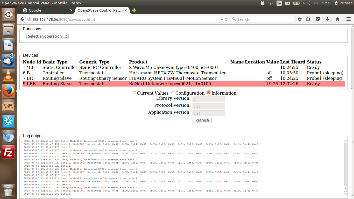

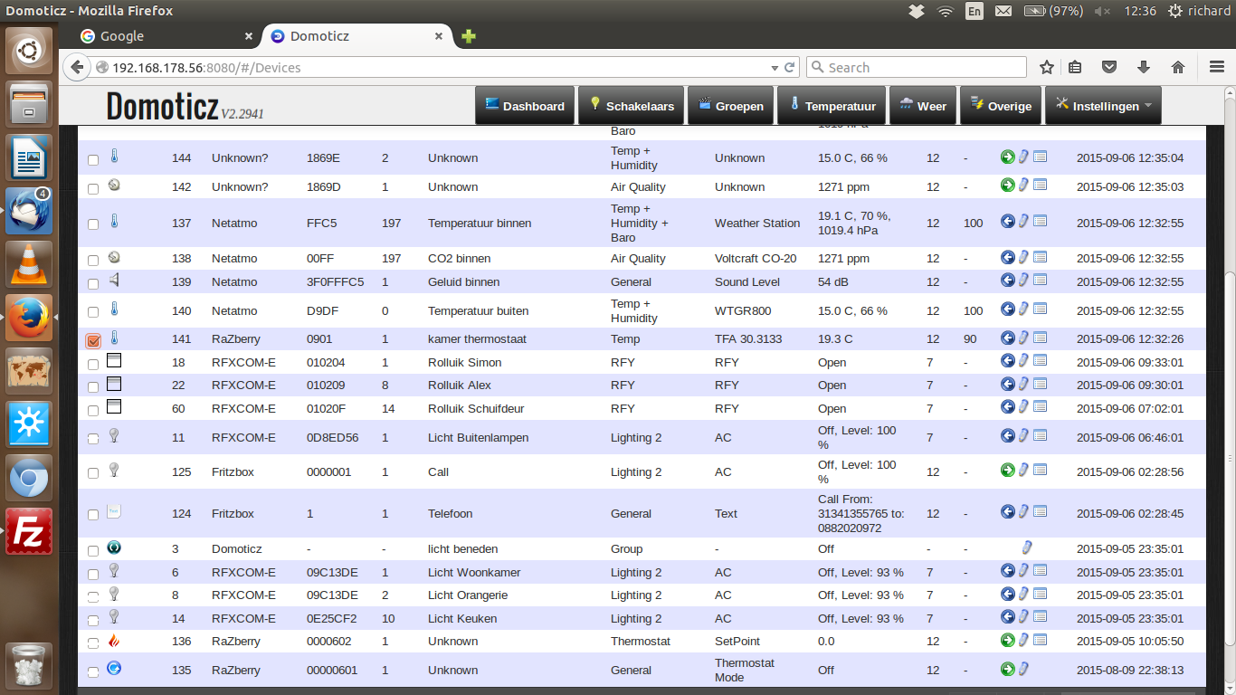

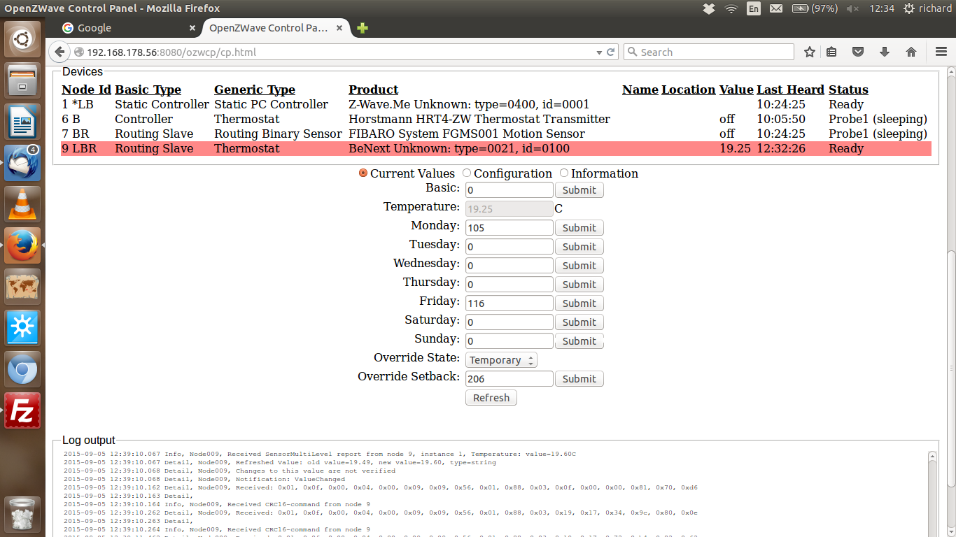

richardv
- Posts: 3
- Joined: Friday 05 December 2014 15:01
- Location: the netherlands
Re: BeNext Heating Control: Not everything is shown
I tried the files, and attached the printscreens from domoticz.
The readings from the room-thermostat (Remeha Isense) now works as before it did not.
But futher no approvement, unfortunately, no thermostats etc were seen by domoticz
Hope it helps you any further,
Richard
Richard
