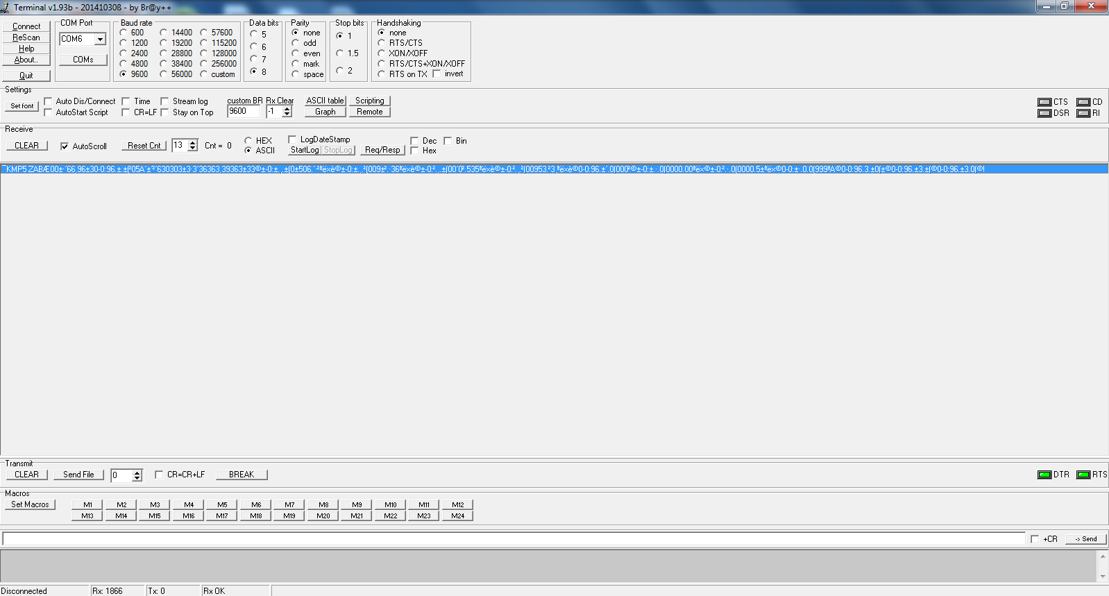

I am trying something similar as described in this topic and I am having some problems getting it to work. My smart meter is a Kamstrup 382JxC and I am using a HL-340 USB to RS232 Serial Port Adapter Cable (from dx.com) to connect the smart meter to a pc running domoticz (on linux). As I wasn't getting any data I connected the smart meter to a windows pc on which I am running Bray's Terminal to see what's coming in on the COM port. I am attaching a screen shot of the terminal. As you can see some characters look like they could be ok but there are also many that aren't. Does anyone know what's going on? Do I need to modify the cable? Or am I using the terminal wrong?
Any hint would be appreciated.
Peter
Terminal Screenshot
Terminal Screenshot
ThinkPad
Posts: 890
Re: DIY cheap USB-cable to read P1 port of Dutch smart meter
Post by ThinkPad »
Hi, welcome to this forum (see you just registered)
Have you tried 115200 as baud rate. And maybe try 'putty' also
Could be the cable otherwise....
