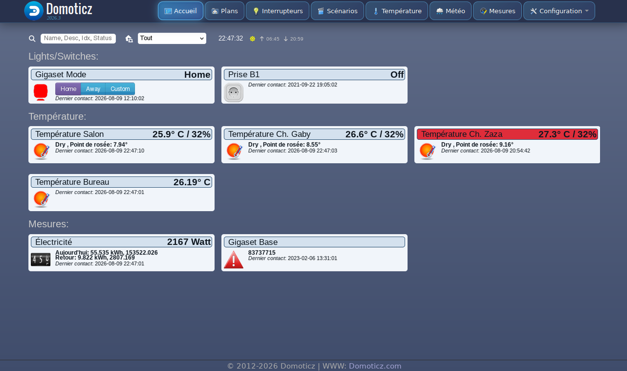

I'm an old dog using domoticz successfully since 2016, but I need your help for the problem that appeared 2 days ago : Most of my devices aren't displayed anymore in the homepage/floorplan/switched etc. tabs if I select the "All" plan. If I select another plan, there are displayed just fine *but* I can't get any log from them :
example on the main screen :
but :
sqlite> select Name from DeviceStatus where Favorite=1;

sqlite> select count(Name) from DeviceStatus where Favorite=1;
27
So only 8 favorites are displayed out of 27 ! And some displayed devices aren't in the favorites (ex Prise B1)

Ok, problem solved.
After further investigation with json call directly, the behaviour looked like an authentication problem. Then I noticed that for some reason, the user used by domoticz on my trusted network has changed from the "normal" admin to an old admin user that stayed there from former times with restricted access to some devices only.
I cleaned-up my admin users keeping only the good one and that was it !
