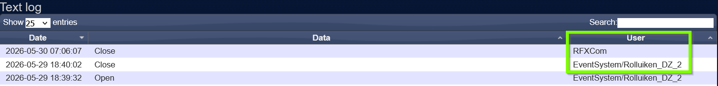

In the logs the user is shown that activated a device.
Is there a way to get that data in dzvents?
The usecase is: RFXCom is a manual action, the others are automated actions

Via the api call
http://<domoticzURL>/json.htm?type=command&param=getlightlog&idx=<id_of the switch>
if it is the switch
