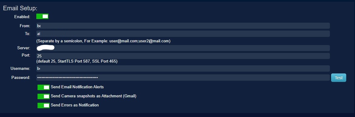

E-mail notifications with a picture (security cam) do not work anymore. Errormessage is:
2026-02-03 17:16:09.188 Error: SMTP Mailer: Error sending Email to: !
2026-02-03 17:16:09.188 Error: libcurl: (55)
2026-02-03 17:16:09.188 Error: Send failure: Connection reset by peer
settings screen attached
error messages and test e-mail are received ok.

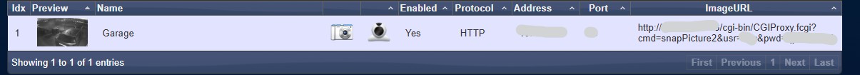

Until recently the mail with a snapshot of the security cam where received.
the snapshot works in the camera settings menu

Does this smtp server you use, support multi form html emails?
Verdwaald
- Posts: 2
- Joined: Tuesday 25 March 2014 21:54
Re: Email is not send with a snapshot atttached
I seems it Doesn't.
Other server, no problem.
It is a Synology mailplus server, so I am a bit surprised.
But it definitly not a Domoticz problem.
Tnx for the assistance.
