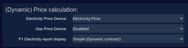

When you have a fixed price contract you can use a P1 meter device that has a separate price for usage and return (and use the same price for T/R1 and T/R2). When your fixed contract ends you can manually update the prices.
You have to set the calculation device to internal meter.
The P1 smart meter device is the device to use to monitor your grid usage and delivery.

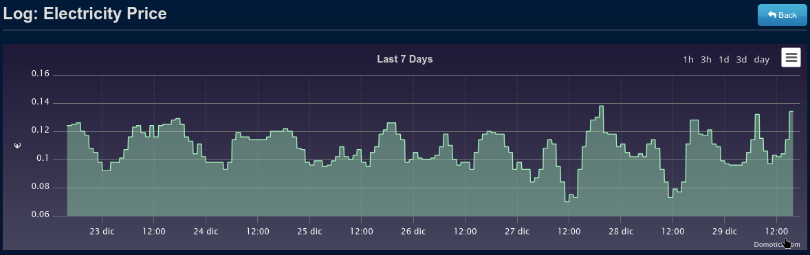

In Italy, energy sent to the grid is paid to a price proportional to the ENTSO-e price, that varies every 15 minutes.
Below an example (this is hourly price, actually price changes every 15 minutes) The used energy price has a different type of cost: it may be
* flat
* change 3 times per day
* change every 15 minutes
For these reason I believe that it will be very versatile and powerful to add in Domoticz a new device for returned energy (energy fed to the grid).
I have a virtual P1 meter, but cannot specify anything: prices are get from Domoticz, same price for usage and return energy. I did not get any possibility to specify two different price for purchased and sold energy.
