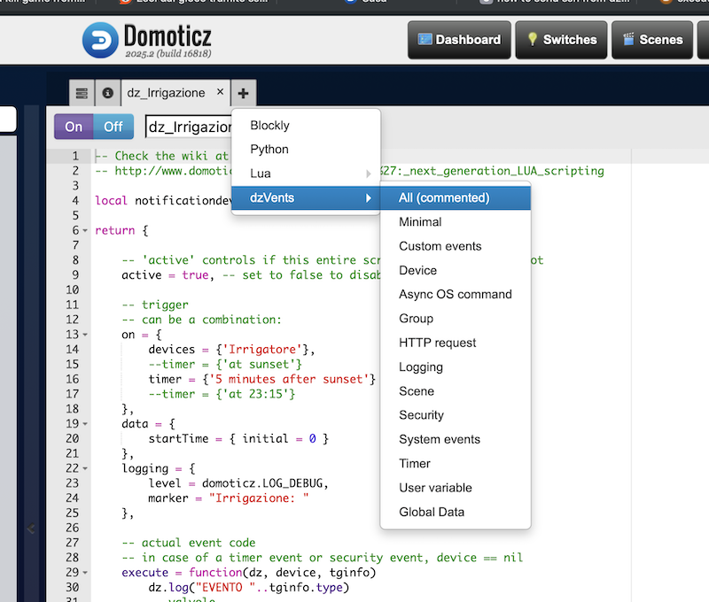

But when I create a new dzevents script, all the templates are disappered.
How can I have them again?

I had the same problem initially.
According to my setup log:
docker exec -it domoticz bash
# cp scripts/templates userdata/scripts	// hiermee zijn de templates zichtbaar in de events editor
# cp scripts/dzVents userdata/scripts
# cp scripts/lua* userdata/scripts
# cp scripts/python userdata/scripts

Great!!!
it works!!!!
