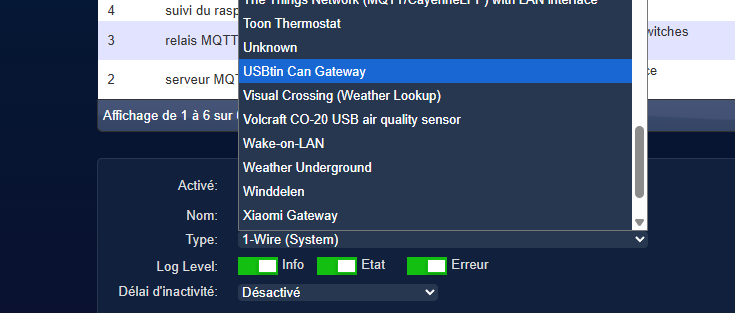

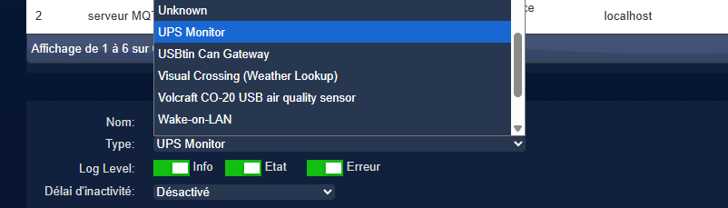

I have attached 2 files showing
before (2025.1)
after (2025.2)
UPS Monitor has disappeared from Hardware Type in 2025.2 vesrion...??? Topic is solved

Hummm
you are totaly right. I didn't notice, but it doesn't run...
I moved my instalation under docker when upgraded to 2025.2
I have tried to instal nardo86/nut-server Docker image, but didn't succeed to have it running
I'm afraid I will loose this function
