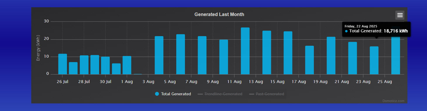

I use the PVOutput for several years with no issues so far.
However since a month, the "Generate last month" graph only shows data every second day.(see attachment)
On the PVOutput website, everything looks fine.
The value shown seems to be the sum of 2 days.
Any idea what can be the root cause ?
Any help is appreciated.

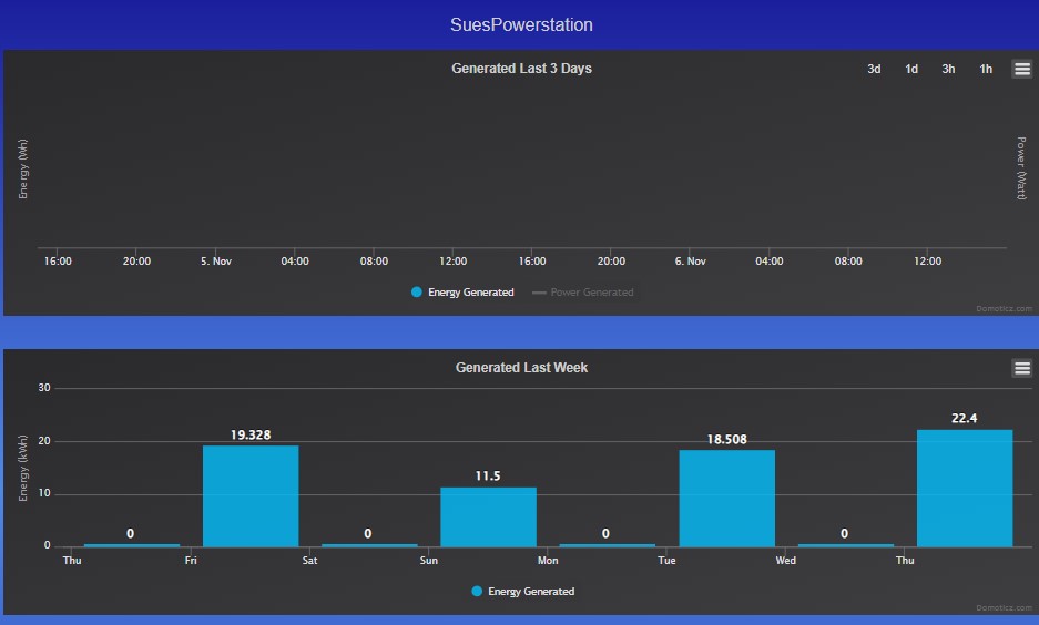

Last accurate daily value displayed in Domoticz was for August 1st.
August 2nd onwards all daily values are incorrect. Actually daily values are 0 since then...every...day.
As per the Domoticz logs can see the PVOutput (import) is reading the counter values (totals) from PVOutput correctly and are updating correctly:
So as per my understanding the hourly generated values are no longer updating/calculated correctly (must be a calculated field right ?)
Most likely something simple to resolve if you know the inner workings of the Domoticz DB. Which goes for most IT problems
Easy to fix for a subject matter expert.
As am not a Domoticz SME and only using it for the monthly totals which are still accurate and ultimately can go to PVOutput interface as well I am just gonna leave it for now.
Thanks for your feedback though. Really appreciated !
