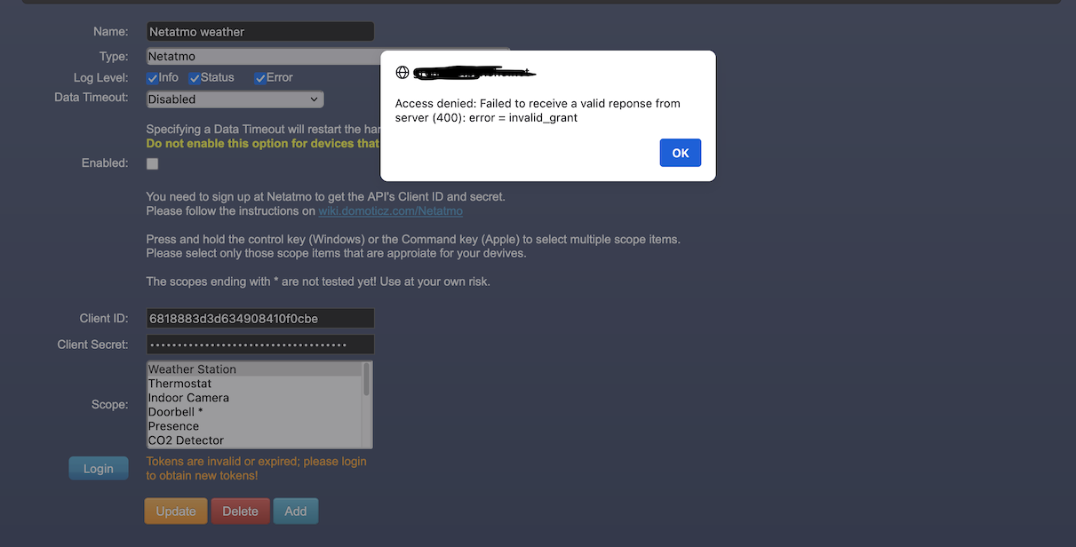

I installed Domoticz 2025.1 and I'm unable to get Netatmo working , getting this error message when doing the login !
- I even create a new Api, with new client Id and Secret, no success.
It was working with the old beta version where we had to generate the token manualy
How can we troubleshoot trhis issue ?

The wiki, seems to be wrong. It is mentioned that "The Redirect URI should contain the IP and port of the Domoticz server. ", and in fact if I removed it then ALL works well.
Would be great that the https://wiki.domoticz.com/Netatmo wiki is updated

The Redirect URI used to be empty before but I got instructions to change it. So for some users it should be empty, for some it should be the domoticz server IP.pipiche wrote: Monday 05 May 2025 12:16 The wiki, seems to be wrong. It is mentioned that "The Redirect URI should contain the IP and port of the Domoticz server. ", and in fact if I removed it then ALL works well.

Yes if you leave the redirect empty it can work,
Until you experience a error and your app gets blocked.
When you fill in the redirect it must be the correct url from the Domoticz instance.
So I suspect there was some mismatch from the url in your case.
Kind regards
Kind regards

So what should be the right url ?
Can you put an exemple ? As is that the external ip, the internal ? Can local host acceptable?

Like the example it's the local IP
Local Host is not acceptable,
If you want to be sure you can open your domoticz in your browser with develop tools and when you open the login page from the plugin, This is what you must put in. For me this is from http://10.0.1.140:8080/#/Hardware
http://10.0.1.140:8080/-

Have you creating a new App into Netatmo portail ?
In several case it's a solution.

hi,
My feedback, same issue as @pipiche
Removing the URL redirect is the solution for me, so it is blank now

A blank URL was not the only solution for me.
Because I have Domoticz and Homebridge running on the same Raspberry, I tried to use the client-ID and clientsecret of homebridge-app in Domoticz, and that seemed to help...
In the homebridge app the Redirect URL was blank as well.

For the people who have a blank redirect-URI can you share some insight in your setup.
Are you using Windows or Docker or linux (raspbian, Kodi, Debian)?
Is your domoticz setup with a static-ip or a DHCP-reservation ?
IP-range ?
Kind Regards
IP-range ?
Kind Regards

No docker, im testing docker for many months on my test machine, but i do not seem to get it working with other containers, like a container with homebridge, but that is something else. So just on linux with static ip and no redirect-url. Ofcourse no scopes, no token generator, that is what domoticz plugi does for you.
Seems to be working for couple of weeks now. Hope you get it working too.
