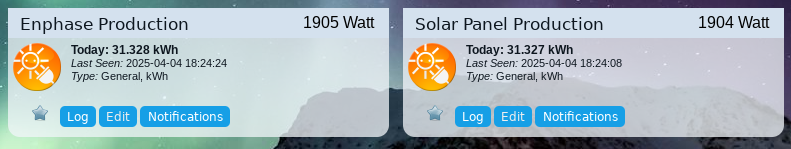

As an example I show you 2 sensors:
Left you see the hardware device of Domoticz Enphase.
As far as I know, this sensor uses the "{ip}/production.json?details=1" endpoint.
Right you see a virtual sensor, that receives the data from Node-RED by MQTT.
My Node-RED flow uses as endpoint:"{ip}/api/v1/production".
You see a very small difference between those 2, but that is caused by the difference in time of the measurement.
See the time in "Last Seen". I poll my Envoy every 30 seconds, during day time.
So in fact, it doesn't matter how you do it.

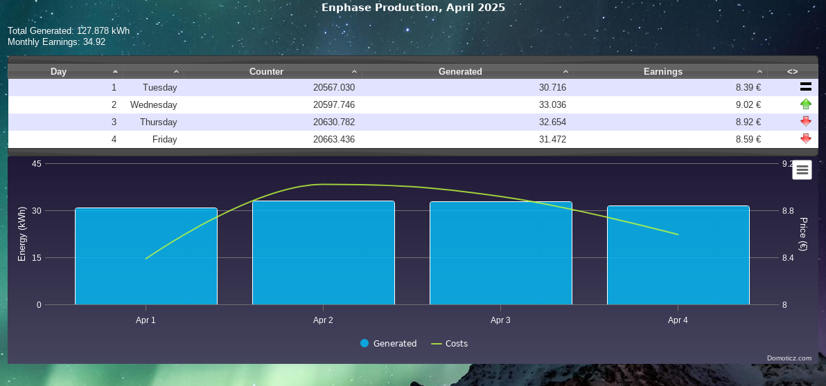

Let's look to the log of both.

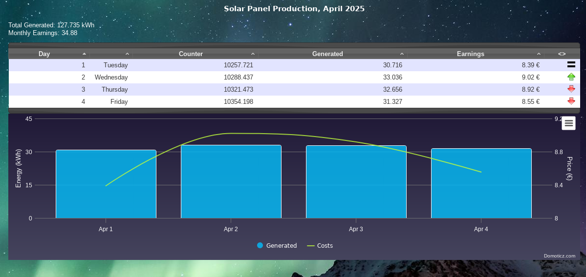

You see above the graph for April 2025 of the Node-RED sensor (which is only 4 days old) and you see the counter gives a value of 10354.198 kWh
This is not the lifetime production, as that counter has been reset in between and I think more than once.
The production between April 1-4 has been 10354.198 - 10257.721 = 96.477 kWh.
Above the graph for April 2025 of the Domoticz hardware sensor and you see the counter gives a value of 20663.436 kWh.
The production between April 1-4 has been 20663.436 - 20567.030 = 96.406 kWh.
the difference again is very small, only about 70 Wh.
But! You see that the counter of the Enphase hardware is in line with the lifetime of your installation.
It is even better than the value indicated in the Enlighten website.
So I very seldom look to the values indicated by Enlighten or the local webpage of the Envoy, but rely on Domoticz.
So it doesn't matter which sensor you compare. The result is more or less the same.
You can look up the counter value at Feb 18 2024 and Feb 17 2025. The difference is your production of last year.
