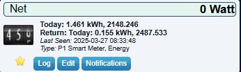

Does anyone know how to get the total used (electric) energy of a specific dag in the past.
The energy is saved in a utility device:
Utility device
Utility device
Schermafbeelding 2025-03-27 083454.jpg (14.01 KiB) Viewed 1507 times

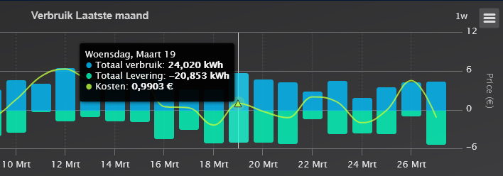

I like to get the used- an return energy value of a specific day of this figure:
Energy per day
Energy per day
Schermafbeelding 2025-03-27 083750.jpg (52.33 KiB) Viewed 1507 times
Thanks in advance

Re: How to get daily used and delivered energy value
If it is just to know you can hover over the specific day and see the value:
Schermafbeelding 2025-03-27 233200.png (44.74 KiB) Viewed 1355 times

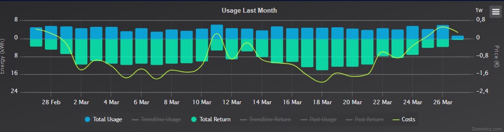

You can also download the excel or csv data from the graph from the hamburger menu, top right.
DateTime	 Totaal verbruik Totaal Levering	Kosten
2025-02-27 00:00:00	20,826	-7,037	4,3118
2025-02-28 00:00:00	20,704	-8,693	3,7558
2025-03-01 00:00:00	31,6	-0,051	9,8654
2025-03-02 00:00:00	17,333	-15,863	0,4597
2025-03-03 00:00:00	17,075	-7,782	2,9059
2025-03-04 00:00:00	14,58	-9,834	1,4841
2025-03-05 00:00:00	10,948	-19,884	-2,7943

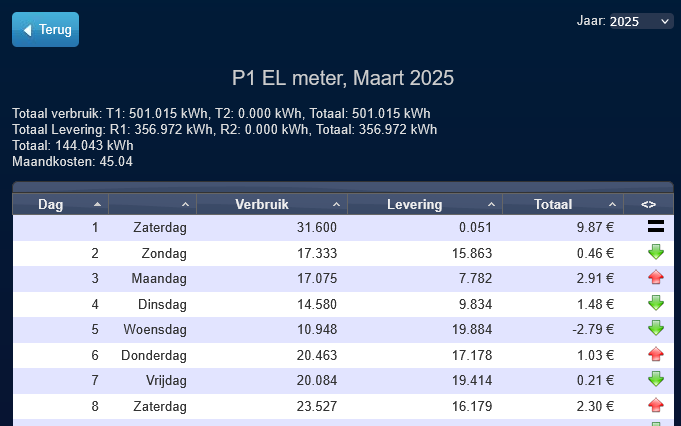

You can also go to the report page (device widget Log button - Report button on top right) and see the values per month per day per year.
Schermafbeelding 2025-03-27 233946.png (40.4 KiB) Viewed 1354 times
