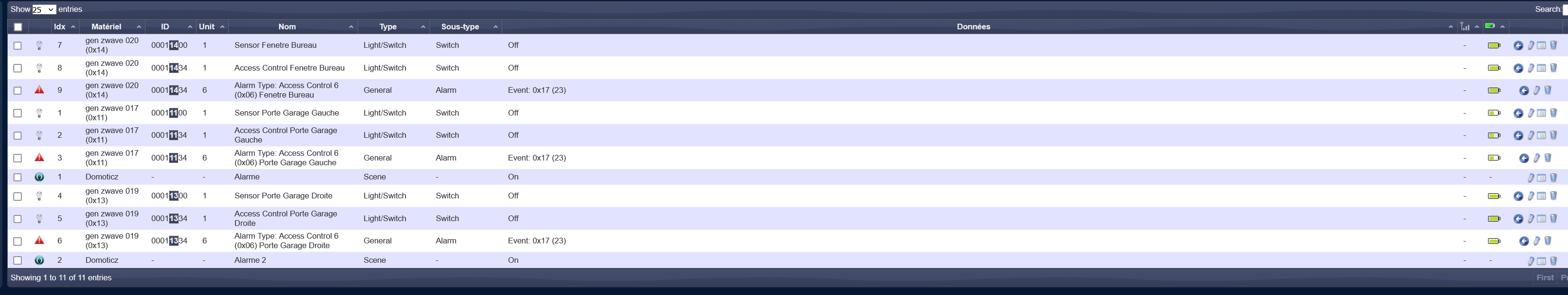

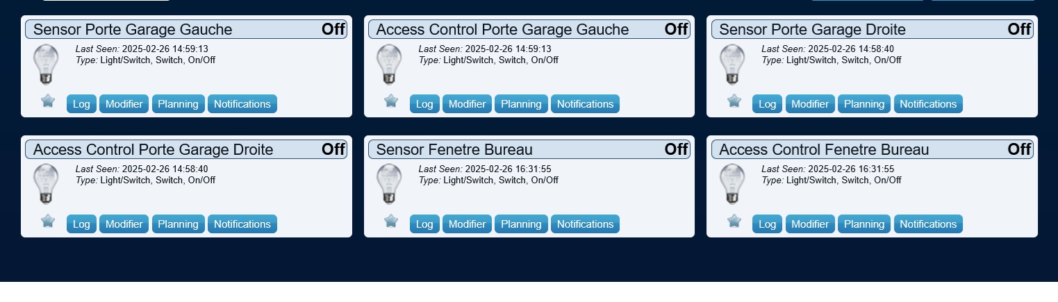

- I start again, this time I reinstall the 3 switches by doing "include a node". I rename them to get my bearings and I activate them, the green dot turns blue.
- I check in switch, there are 3 times 2 inter

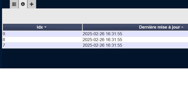

- I want to create an event and there I only see the first switch that I installed.
- I do + to create an event and in switch there is "nodevice found".
- then the 3 switches appear in event after having done things but I do not know what. but only the office inter is in switch.
