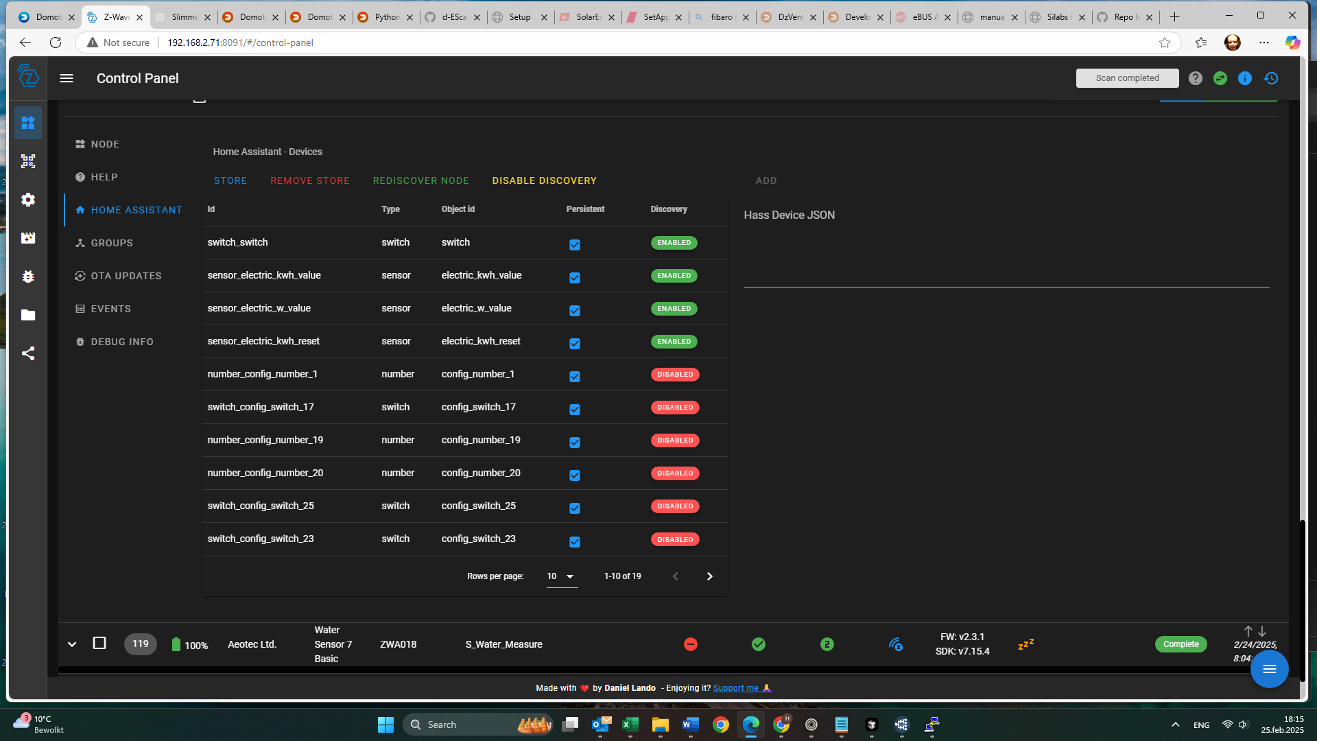

I see that my initial readout of data from Zwave-JS UI is totally flooding the data readout for 5 minutes, all the settings are included.
Is there a setting to exclude all the settings are read by "MQTT Auto Discovery" and only get the on-off and current data, and leave all the settings in the app. Wolud also reduce the cluter in the devices tab
Just wondering
Is there a way to only get the essential data

Re: Is there a way to only get the essential data
I've done it like this, but this means reviewing all files
- Screenshot 2025-02-25 181545.png (302.41 KiB) Viewed 3914 times
Yup, better mention this in the zwave-JS-Ui forum to see if they have better ideas to handle this.
