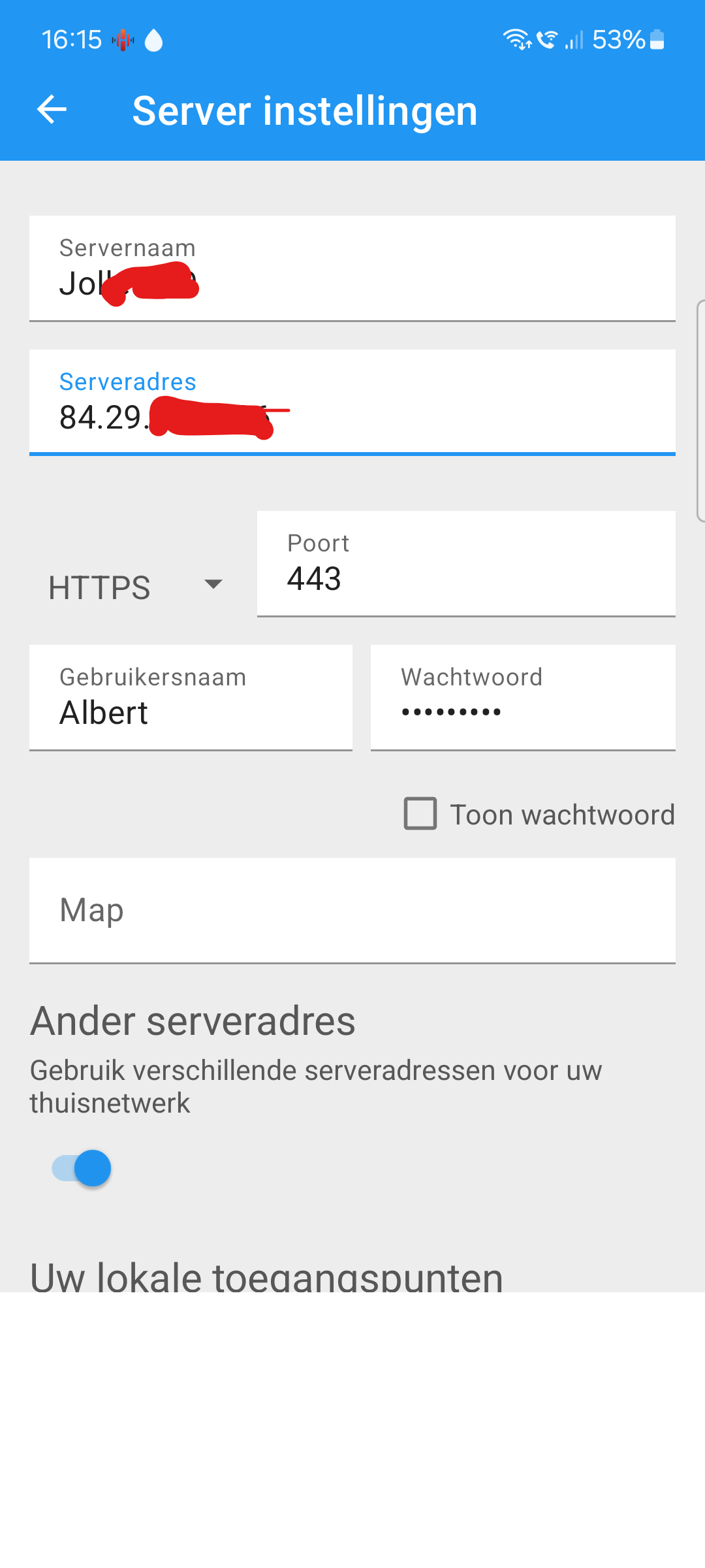

I am using Domoticz since 2018 with great pleasure. Due to a change of employer i had to reset met Android phone samsung A53. After downloading the app (version 0.2.381) i can't get it to work. I tried to acces on my tablet but got the same result. Unfortunately i didn,t make notes of the Domoticz app settings so i am unsure if i did it right. I've added a screenshot to show what i am using.

That start of the IP address is an public internet address, so are you trying to connect via the outside?
If so, you must have a port forward setup in you internet router. Did you check what is defined there?

i am trying to connect via the outside, but also via an internal ip number. At home i can reach Domoticz via a browser and everything works. This has worked untill a week ago. nothing changed on my router. Only my phone,
Can you assure these are the correct settings in the app? or point me to a post where is described?
i am using port 443. The last days i learned this is a security risk, thank you for bringing this to my attention. Once i get the app working again on the existing router settings, I will change this. For now i want to limit the variables.

All you really need to do is to use the exact same information as you use in the Computer Browser:
  • Ip address
  • port
  • Username
  • Password
.. and things should work. In the App you can define 2 IP-Address/Port combinations: One for internal and one for external use.
Just start with trying to get it to connect via the internal LAN and check the Domoticz log for errors when trying to connect.

It's working again :)
Just to be sure i checked port forwarding in my Ziggo router. There was no line for ssl so i added a line for port 443. It fixed the problem, nice. But now i'm wondering why it worked before? I didn't change anything in my router for over a year. I let this rest.
Then i wanted to up security and changed the port in domoticz.sh.
OLD: DAEMON_ARGS="$DAEMON_ARGS - sslwww -443"
NEW: DAEMON_ARGS="$DAEMON_ARGS - sslwww -54300" . Rebooted my raspPI and added a forwarding line in my router for this port but then Domoticz didn't work anymore. Not even via a browser.
Changed it back to 443 and have a working app again. For now i'm happy. Any advice on the correct way to change the SSL port?

2Stroke wrote: Saturday 25 January 2025 14:08 It's working again :)
Just to be sure i checked port forwarding in my Ziggo router. There was no line for ssl so i added a line for port 443. It fixed the problem, nice. But now i'm wondering why worked before, i didn't change anything in my router for over a year. I let this rest.
Maybe you used an VPN from your phone to connect to your Home LAN? That way you could connect using the LAN ip.
2Stroke wrote: Saturday 25 January 2025 14:08 Then i wanted to up security and changed the port in domoticc.sh.
NEW: DAEMON_ARGS="$DAEMON_ARGS - sslwww -54300" . Rebooted my raspPI and added a forwarding line in my router for this port but then it didn't work anymore. Not even via a browser.
Not sure why you need to use another port on the inside, but I would use a HIGH PORT on the outside of the NAT in your router.
