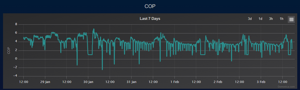

in the meantime (apologies for not responding earlier), I created a Dzvents script that takes two key parameters generated by my heat pump (via the EMS-ESP "BBQ-kees" gateway): 'meter heating' ("eIn", the energy consumption for heating purposes) and 'energy heating' ("eOut", the energy generated by the heat pump). These are accumulating numbers updated every minute.
I found on https://www.gridx.ai/knowledge/coeffici ... rmance-cop and on https://en.wikipedia.org/wiki/Coefficie ... erformance that for a heat pump, used to heat a space, one could use:
COP = (eOut + eIn) / (eIn)
(for cooling a space the article suggests COP = (eOut) / (eIn)). That makes sense.
In order to calculate the COP, I need to decide over which time period I want determine the COP. I have taken 10 minutes for now (adjustable), I'm not sure how much time makes most sense yet. The script keeps track of the eOut and eIn and determines delta's for both over 10 minutes and calculates the COP over that period. The result is sent to a Custom Sensor virtual device. The sensor provides as usual in its log averages over days/months/years. The 10-minute-COP's averaged over -say- a week is obviously not the same as the COP calculated over that same week.
Some further care is taken to ensure the 'eIn' and 'eOut' originate from the same data message from the heatpump, it is not guaranteed that both eIn and eOut are updated at the same time in Domoticz, neither do I know which of them if first/last updated.
This is a (very) first working version (updated 250203):

** Description
Objective of this script is to show the COP of my heat pump on a Domoticz device.
The script calculates the COP based in two parameters provided by the ems-esp gateway between my
heat pump and Domoticz: 'meter heating' ("eIn", the energy consumption for heating purposes) and
As found on https://www.gridx.ai/knowledge/coefficient-of-performance-cop, you can use
COP = (eOut + eIn) / (eIn) to calculate the COP.
The script is triggered by updates of the eOut device. As I cannot be sure that eIn is updated before
eOut (or vice verse), the script triggers itself again a few seconds after the eOut trigger using
a Custom Event. This ensures both eOut and eIn originate from the same heat pump data sample.
The COP is calculated over several updates of eOut/eIn, for example spanning a period of 10 mins. An
internal sample counter is used for this.
The value of eOut and eIn is stored using a persistent variable. The script has some means to
reinitialize these values.
The COP values are sent to a dummy device of type general/custom counter. this device proides the
usual Domoticz averages 7 days, month, year, compare years. Note that for example the months COP
average is not the same as the COP calculated over a period of a month.

- I'm not sure about the best time span (number of samples) to wait before a practical COP calculation
- during deicing, the heat pump uses heat from inside, so eOut will decrease, COP will be <1 or even
this could lead to negative COP if deicing during sample period takes more energy then eIn over same period

dz.devices(copSensorIdx).updateCustomSensor(cop)
-- some further testing to find out what causes a negative COP
-- noted that eOutDelta can be negative, perhaps when heat pump is de-icing?
if (eOutDelta < 0) or (eInDelta < 0) then
dz.log('One of these was negative: eOutDelta = ' .. tostring(eOutDelta) .. ' eInDelta = ' .. tostring(eInDelta), dz.LOG_ERROR)

Based on what I found using Google (links in the earlier post), I'm using CoP = (energy-out + energy-in)/(energy-in), e.g. exactly 1 more than above. I understood this is because I'm looking at a CoP for heating, not cooling. However, I'm not an expert! Also, I think you need to consider the energy in/out over a certain time period, yet I do not know how much time is optimal. In the attached example, Energie-out/in are calculated over 10 mins (my heat pump provides the accumulated energy out/in every minute), yet the result is still quite 'noisy', so I probably need a longer period. Lastly, if the heat pump is not running, energy-in is obviously zero (divide by zero), so I capture that (by not giving an update on CoP in that case). Also noted that in some cases energy-out can be negative, which is probably when the system is deicing. Even to the extend that the CoP itself becomes negative. Unfortunately, the position of the 4-way valve in the heat pump (e.g. heating or cooling/deicing) seems not to be exposed via the EMS-ESP gateway.
Note that the Domoticz graph takes the 10-minute CoP updates and interpolates every 5 minutes for the graph. Perhaps I should rather use a bar-graph. (the script code in my earlier is updated to what I'm currently testing with)
