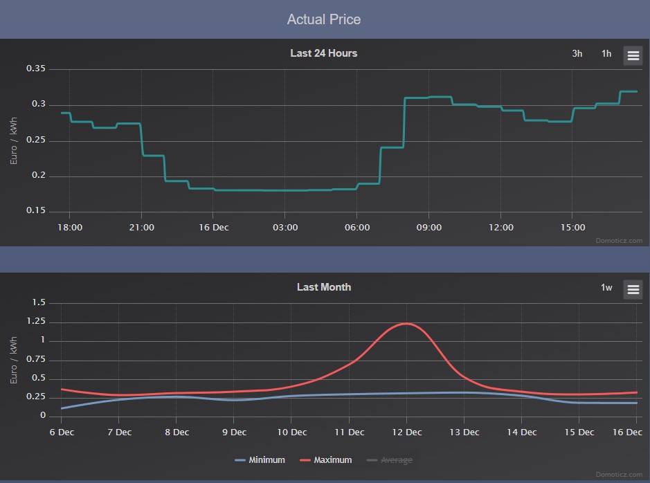

Adding to the issue:
Here is the last few days of price sensor, again proving that the sensor updates properly. But isn't used properly (most likely due to the sensor timeout). I don't necessarily want to modify the timeout for ALL sensors, but only for this one ...)

In this code T1 and T1 are low and high tarif respectively.
Dynamic costs is calculated from a sensor driven by Enever Dutch Electricity/Gas Price Feed plugin.
Whenever the dynamic tarif changes the script is triggered and calculates costs using the delta and the tarif of the past hour.
I wrote this script to get insight if it is profitable to change from normal tarif to dynamic tarif.
The sensor from the plugin behaves like this:
