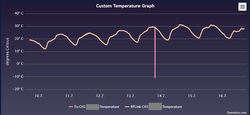

Is there a simple way to add median filter for temperature sensors? My 433 MHz sensors someties report erroneous values, very high or very low. I would like all my sensors to use the median value of the last three measurements, like median(t0,t1,t2).

Erroneous temperatures are quite rare but those are bad for plots and statistics. This was one of the coldest days in last year but the highest received temperature is +186.5 C.
I had an older version of RTL_433 (https://github.com/merbanan/rtl_433). I updated to the lastest version. Let's see if this helps.
There's a CRC error detection used in temp/humidity reports but I don't know how these are handled. I don't have any logs when erroneous values are sent.
I tested this DzEvents script. A new value is received and updated to the sensor but then this scripts will calculate the median value and updates it to the sensors.

}Short spikes of 21 C are not shown in plots.

I compiled the latest code for rtl_433 and added the same sensor by RFLink. rtl_433 shows an erroneous temperature value but RFLink does not show it.

My RFLink has difficulties receiving updates from a sensor which is behind two walls. rtl_433 seems to get all updates but shows faulty temperatures. RFLink has higher gain antenna. Due to limited space rtl_433 receiver and RFLink are about 40 cm away from WiFi access point.

I think I should be able to redirect the output from rtl_433 simultaneously to a file and to Domoticz by adding an extra parameter "-F json:/tmp/rtl_433.json"waltervl wrote: Thursday 24 July 2025 13:12 You should capture the rtl_433 log on the rtl_433 device and change the rtl_433 code so it does not send corrupt data
See running discussion there: https://github.com/merbanan/rtl_433/issues/1964
std::string szFlags = "-F json -M newmodel -C si -M level " + m_cmdline;
https://github.com/domoticz/domoticz/blob/development/hardware/Rtl433.cpp#L627Domoticz shows measurements reveiced by rtl_433 but the file /tmp/rtl_433.json is not created. Domoticz log shows the argument without a /
2025-10-18 13:23:11.406 Status: RTL_433: Worker started... (Extra Arguments: -F json:tmprtl_433.json)Edit:
Characters ;/$()`<>|& are removed from the argument.
https://github.com/domoticz/domoticz/bl ... 33.cpp#L27
I changed the argument to "-F json:rtl_433.json" . The file rtl_433.json is now written to Domoticz folder which in my case is /home/pi/domoticz
To find temperatures over 100 C, I can use the command:
sudo jq 'select(.temperature_C > 100)' rtl_433.json-
