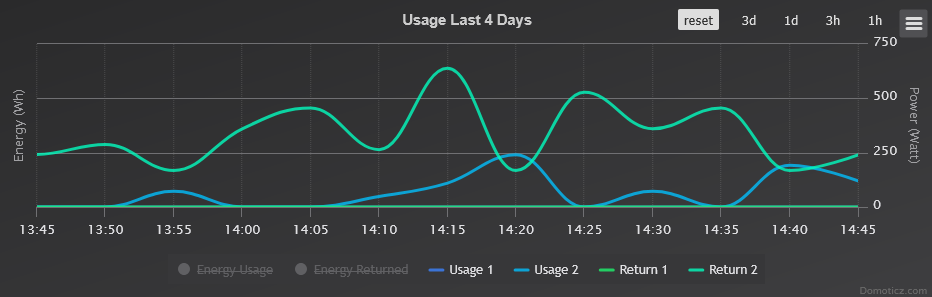

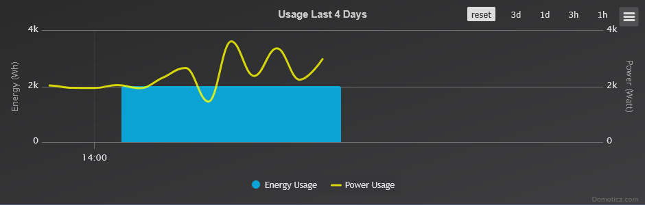

It uses MQTT to switch a SmartEVSE switch.
See how it handles available power.
Power
PV power.png (34.74 KiB) Viewed 2570 times
PV Power
Bugs bug me.
