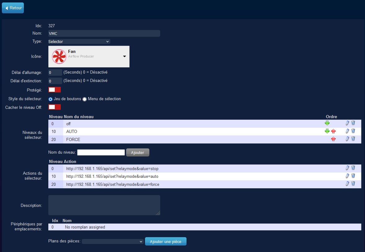

I have created a switch selector with 3 functions: off, automatic, forced .

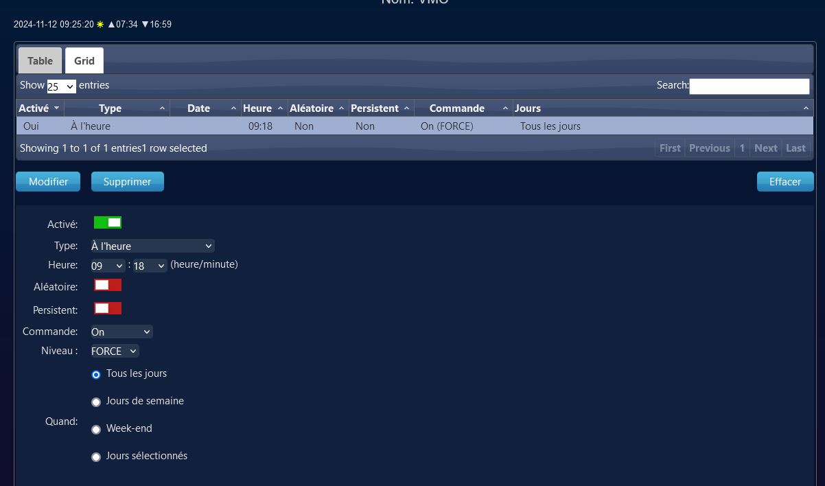

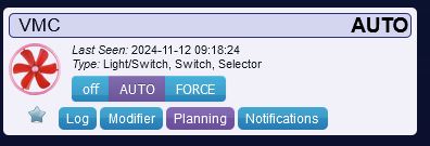

If I manually set the selector to OFF/AUTO/FORCE, it works perfectly, but it doesn't work in programming "planning", or I'm missing something.
In this example, I switch to FORCED mode at 9:18 and nothing moves ... Either it's a bug, or I'm the one who doesn't understand anything

by waltervl
Do not rename the default OFF (value 0) to something else.
Make a new value 30 for FORCE.
With the edit button there is an option to hide the OFF (0) value.

I have modified my initial request in order to better understand my problem. When I use the switch button, it works fine, but it's only the programming "Planning " that doesn't work.

For testing timers always take a time more than 2 minutes in the future to let Domoticz be able to configure the timers correctly. If you are too short on the current time then Domoticz can miss it.

Indeed, I was too short on timing ... I've just redone the test with a 10-minute gap and it's working fine...
Thanks a lot. Problem solved
