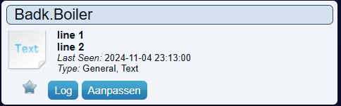

I'm struggling with a textdevice which I want to show information on two (2) lines.
command in dzVents
dz.devices(1642).updateText('line 1'..'\n line 2')
this results in:
line1 line2
but I expected
line1
line2
what's wrong?

The problem is weird.
It apprears that the text-device itself had no problem but it occurs once the same textdevice is placed on floorplan.

your solution works fine for textdevice but if it's on a floorplan it shows up as:
feels like being a bug
