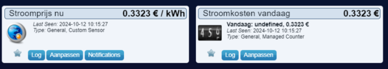

I installed the Enever hardware gateway. All 4 devices appear and actual energy/gas prices are correctly displayed. However, both other devices, containing the counter/daily cost just display a copy of the actual price.

Counter "Stroomkosten vandaag" is a counter that will display the energy costs of today over time in the future. So if you have a dynamic contract you will see that costs around 12 will be lower due to for example solar power if it is a sunny day. In that way you can figure out what the best time is to charge your car.
On you normal Domoticz energy counter (eg P1 smart meter) you will get an extra costs line in the log section so you will see the costs of today for that particular.
This will happen for all energy counters in your Domoticz system.

Thanks for explaining. Even after rereading the docs I still needed your explanation understanding this is a future asset. I had already written my own Python program doing the cost calculation per hour, so I have a device counter showing today's total cost in Utilities and a cost line in Log. The same cost line will be shown using the Enever hardware gateway, but not (yet) the device cost counter in that case. I prefer using the official Domoticz program, that was my reason for asking. The image in the post shows output if Settings | Settings | Meter/Counters is using the Enever devices; if I use my custom devices the daily total cost will be shown.
