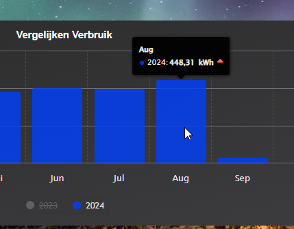

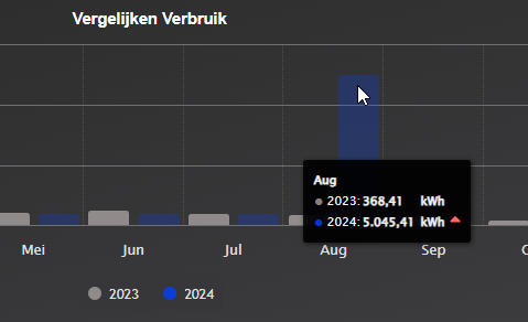

You might be right about the resets, I think I had the problem with my own scripts to update other meters I have (to calculate the direct used PV and real energy usage). These scripts did not handle the resets to 0.
And do you know about the month compare graph, were you able to fix that one? Other graphs I was able to fix by deleting the incorrect day values. But the month compare graph keeps showing the spike for the month total.
The report table shows the corrected value though, will the graph be fixed after the month ends? I don’t know how the value for the month total is calculated, by diff of the counter for start and end of month, or by summing all day values of the month.
The graph seems to be doing the first (at least for the current month) and the month report the last.

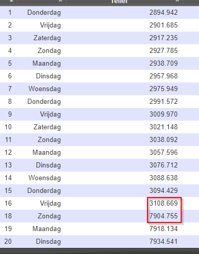

rowid	DeviceRowID	Value	Date	Counter	Price
107941	8023	26919	2024-08-06 00:00:00.000	3780803	5.2376
108002	8023	17667	2024-08-07 00:00:00.000	3798470	3.3184
108064	8023	7182913	2024-08-08 00:00:00.000	10981383	1454.4884
108126	8023	14854	2024-08-09 00:00:00.000	10996237	2.3638
*** Wait ***
Something else is going on... the 'counter' received from Enphase has a big jump!!! It was not reset...
My current value is
"whLifetime": 7781778
my uservariable still has a value of
3578.851000
This because I has some resets in the past when I turned of the power.
I wonder what happens if I turned off the power from the Envoy gateway, will it reset to 0 again? And will this correct the counter again the next day?
Still some patching up to do in the database
(No time to test this, maybe someone else could)
We could use a minus value for the uservariable (in my case probably subtract 7182913)

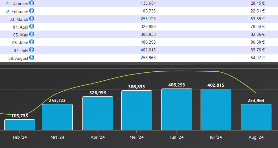

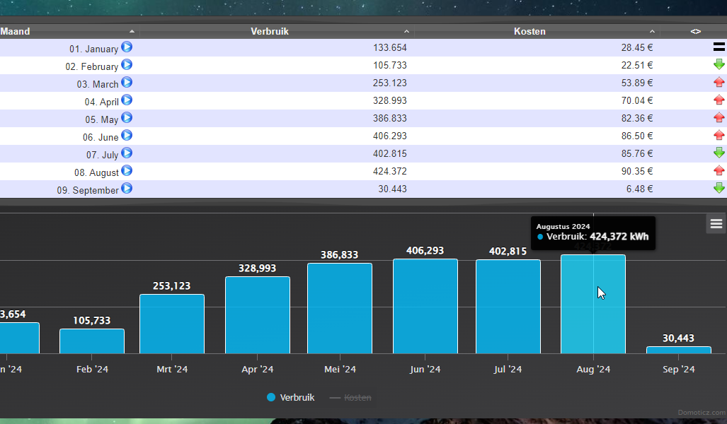

Following your steps to correct the spike i managed to do so. I just have one strange thing i can not really explain.
The month total in the graph is still showing 24kwh above what it should be. The DB values all add up to the correct amount and when i click to the report, the table and the graph there also show the correct amount.
How is the month overview graph calculating the month values and how can it be that it is still too high?
Month graph too high:
Report correct:

That is what i thought it would be, but when i calculate it myself with the counter value, it still should be 424.32 and the year overview per month on the main meter page still shows 448.31
Below my Meter_Calendar data for the Enphase meter.
It should be 3319314 (2024-08-31) - 2894942 (2024-07-31) = 424372 (= 424,327). This is the correct value and is shown on the report page.
So i am a bit in the dark to why the main page month graph still shows 448.31 for august.
Edit: Even when i add up all the Value column values for august it results in 424372.
rowid	DeviceRowID	Value	Counter	Date	Price
11415	172	13707	3349757	2024-09-02 00:00:00.000	0
11398	172	16736	3336050	2024-09-01 00:00:00.000	0
11381	172	16974	3319314	2024-08-31 00:00:00.000	0
11364	172	16114	3302340	2024-08-30 00:00:00.000	0
11347	172	13243	3286226	2024-08-29 00:00:00.000	0
11330	172	18113	3272983	2024-08-28 00:00:00.000	0
11313	172	18766	3254870	2024-08-27 00:00:00.000	0
11296	172	12407	3236104	2024-08-26 00:00:00.000	0
11279	172	13345	3223697	2024-08-25 00:00:00.000	0
11262	172	6226	3210352	2024-08-24 00:00:00.000	0
11245	172	9954	3204126	2024-08-23 00:00:00.000	0
11228	172	11117	3194172	2024-08-22 00:00:00.000	0
11211	172	14538	3183055	2024-08-21 00:00:00.000	0
11194	172	6120	3168517	2024-08-20 00:00:00.000	0
11177	172	16407	3162397	2024-08-19 00:00:00.000	0
11160	172	13379	3145990	2024-08-18 00:00:00.000	0
11431	172	19300	3132611	2024-08-17 00:00:00.000	0
11126	172	4642	3113311	2024-08-16 00:00:00.000	0
11109	172	14240	3132611	2024-08-15 00:00:00.000	0
11092	172	5791	3094429	2024-08-14 00:00:00.000	0
11075	172	11926	3088638	2024-08-13 00:00:00.000	0
11058	172	19116	3076712	2024-08-12 00:00:00.000	0
11041	172	19504	3057596	2024-08-11 00:00:00.000	0
11024	172	16944	3038092	2024-08-10 00:00:00.000	0
11007	172	11178	3021148	2024-08-09 00:00:00.000	0
10990	172	18398	3009970	2024-08-08 00:00:00.000	0
10973	172	15623	2991572	2024-08-07 00:00:00.000	0
10956	172	17981	2975949	2024-08-06 00:00:00.000	0
10939	172	19259	2957968	2024-08-05 00:00:00.000	0
10922	172	10924	2938709	2024-08-04 00:00:00.000	0
10905	172	10550	2927785	2024-08-03 00:00:00.000	0
10888	172	15550	2917235	2024-08-02 00:00:00.000	0
10871	172	6743	2901685	2024-08-01 00:00:00.000	0
10854	172	12173	2894942	2024-07-31 00:00:00.000	0
10837	172	19071	2882769	2024-07-30 00:00:00.000	0
