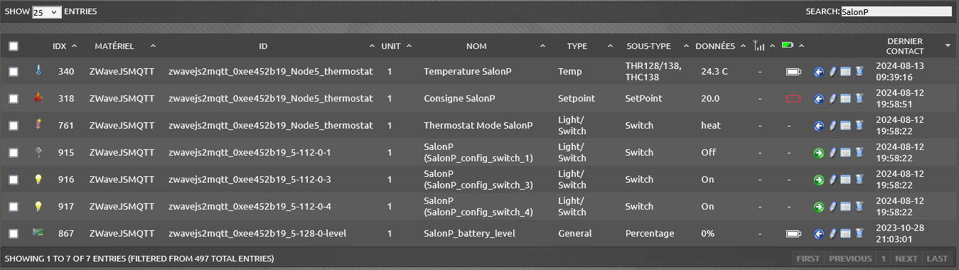

The Eurotronics valves present multiple sub-devices (Temperature, Setpoint, Mode, etc.), including "Battery level" subdevice.
The Battery level is incorrectly displayed in UI (0% while the battery is full), but the main problem is that "Temperature SalonP" and "Consigne SalonP" are associated with different battery levels:

As you can see, the "SalonP_battery_level" seems a bit strange to me: BatteryLevel=100, but nValue=0, sValue=""
And "Consigne SalonP" get BatteryLevel=5 while "Temperature SalonP" gets BatteryLevel=100
I have been seeing this consistently for at least the last 2 versions of Domoticz (I have activated battery level notifications and get daily spammed with false indications).
The device is otherwise working great (accurate temperature reporting, Setpoint change, etc.)
