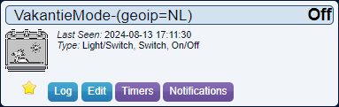

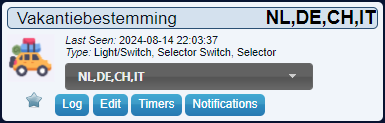

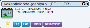

- In addition to Domoticz I was also able to change the port for zwave-js-ui, so that it is also not set to the default anymore.
Adjusting the allowed countries in iptables is now done per script from Domoticz, which changes the rule for geoip and is shown in the name of my VacationMode device.
  • A script retrieves the start and end times of vacation from my agenda (ical) and uses it to set the timer of my Domoticz VacationMode.
  • When VacationMode switches ON it triggers my vacationmode script that changes a number of devices (boiler, EVObhome, changed schedules for lights etc.).
  • The vacationmode script now also calls my bash script for iptables, which changes the ipv4 and ipv6 rule for the allowed countries.
  • At the end this script renames my VacationMode device to show the allowed countries. (see image as an example).
  • And of course all actions in the opposite direction when vacationMode is switched off by the timer and the vacationmode script is triggered again.
At the moment I still have to adjust the script in time to change the code(s) for holiday destination countries.
The last step, to fill in the desired countries somewhere, I still have to think about. :-)

And the finishing touch is in a selector device with travel icon :D.
I have added some combinations of common destinations with transit countries in the selector.
Here I can make a selection for my next vacation.
I now can adjust the script to obtain the active selection when the VacationMode switches ON.
Then it can use this selection to set the iptables geoip rule.
And when the VacationMode switches OFF, the script can set both selector and iptables geoip rule back to the home country.
