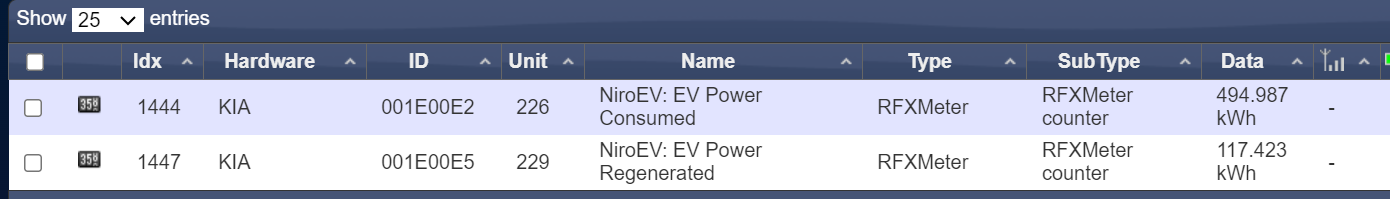

Is this correct? These devices monitor power (according their names) and report in kWh. I always thought that power is in W and not in Wh!?
- power-kia.png (55.43 KiB) Viewed 5312 times

You are correct. They measure energy used/regenerated. You can rename them.DiaDomo wrote: Monday 12 August 2024 10:56 Is this correct? These devices monitor power (according their names) and report in kWh. I always thought that power is in W and not in Wh!?
