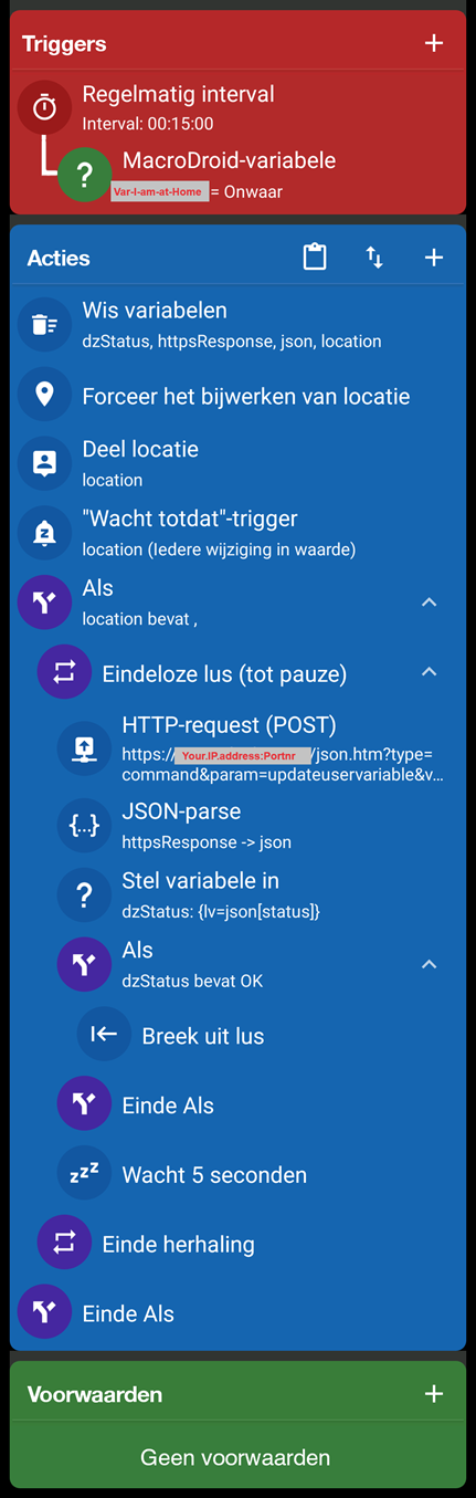

Step 1:
I use the Macrodroid app on my smartphone. You may have or want other options for this, but this is what I use to explain and show it.
It's a bit of a puzzle, but I'm getting better at it. A lot is possible. See the explanation below the picture.
Explanation of these steps in Macrodroid:
  • Macrodroid is triggered by a timer every 15 minutes only when its boolean varable that I am not at home is set (by geofence).
  • It cleans all the local variables used in the macro.
  • It forces to update the current location.
  • It stores the coordinates in a local string variable 'location'.
  • it waits until the variable is changed.
  • When location is retreived, it goes into a loop.
  • Update Domoticz uservariable with the location string.
  • Obtains the 'httpResonse', Parse the JSON to 'json' and gets the status in variable 'dzStatus'.
  • When dzStatus = OK, we get oout of the loop, If not we wait 5 seconds and try again.
The variable (type 2 = string) is updated with the following command:
https://yourip:yourport/json.htm?type=command&param=updateuservariable&vname=<YOURVARIABLENAME>&vtype=2&vvalue=<YOURLATLONGSTRING>
Tested this afternoon and until now works very well and very fast.
