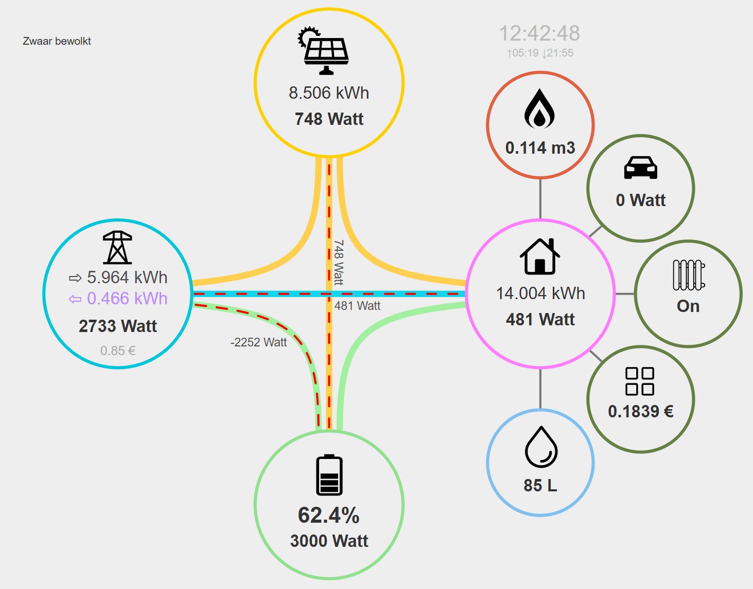

Since Domoticz beta 16049 there is a new Energy Dashboard included.
@MeneerKlaas started with this in the below topic:
https://www.domoticz.com/forum/viewtopi ... 38&t=42345
Since than I have been modifying this heavily and I included it by default into the system!
This dashboard is useful for users using a P1 Smart Meter (Electric/Gas), Water Meter, Solar, Battery, Car charger etc.
Screenshot:
The first step is to configure the dashboard. This can be done via the menu Setup->Settings
The dashboard itself can be found via Setup->Energy Dashboard
This is still a work in progress and probably needs some more work.
Edit Waltervl: There is also a wiki page for the Energy Dashboard
https://www.domoticz.com/wiki/Energy_dashboard
And for the costs an entry in the Settings Wiki:
https://www.domoticz.com/wiki/Applicati ... alculation

Small remark. This is my Airco, which is a General / kWh meter. Some overlap.
