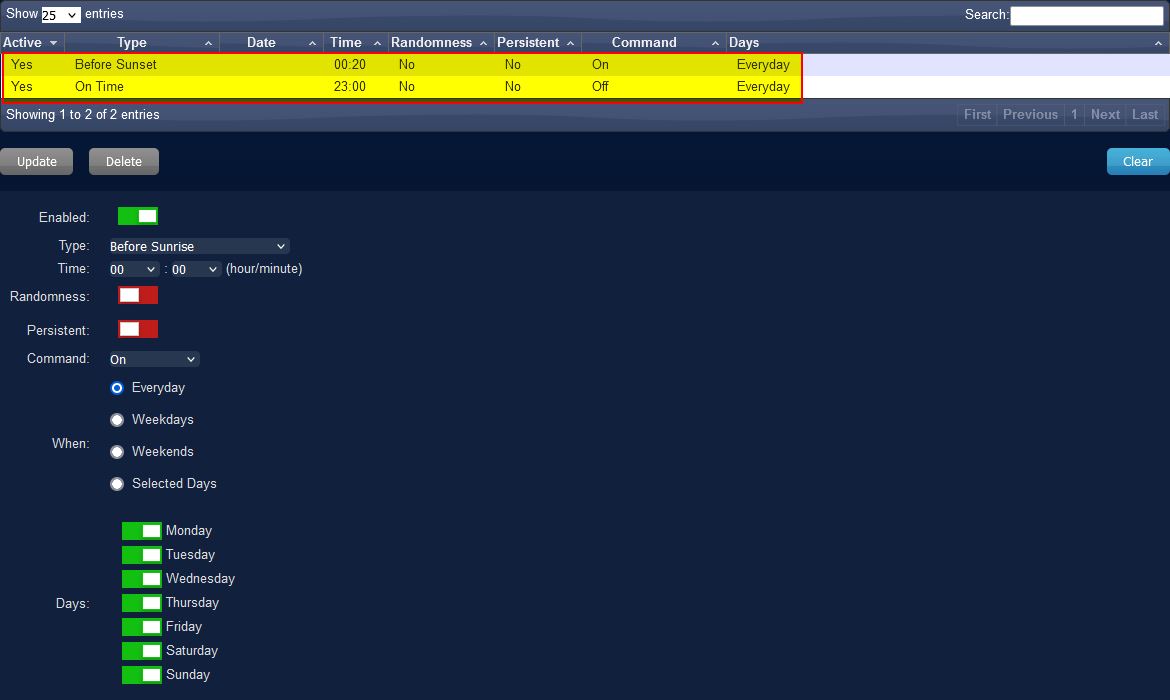

I'm trying to find out if i can get the Timer info of a device\group:
didn't found anything in the documenation. What i need is wen this device\groep is turned off. here above 23.00. Any idea's?

- gizmocuz
- Posts: 3026
- Location: Top of the world
Re: Get device Timers
Just open your browser, open the developers console (F12) (let it dock at the bottom of your browser if not already) select the network tab,
and go to the timer page
You will now see the URL to call

Thanks for the tip, so there is (now?) this API using a device idx that'll show it's timers directly filtered out for instance:
/json.htm?idx=XXX¶m=gettimers&type=command-
