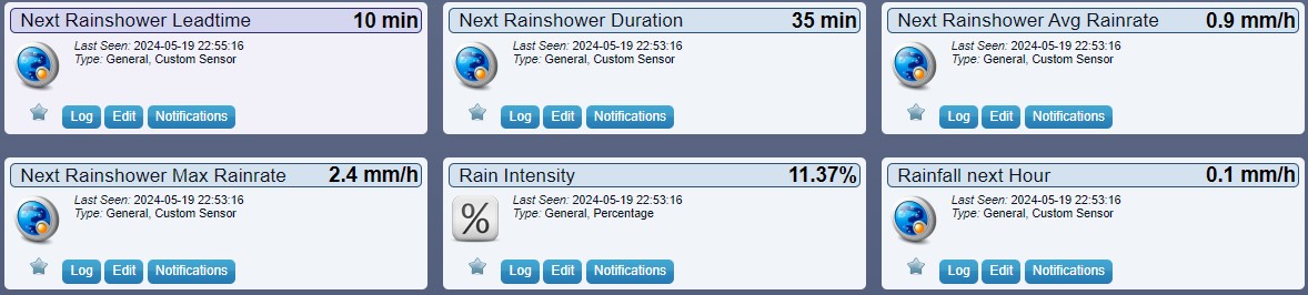

We're using the Buienradar plugin data.
When you have installed buienradar you can see rain and upcoming rain information like this.
One can display the same information into a dummy text sensor like this.
The code is here. (just an example)
