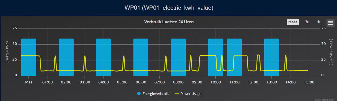

I'm using Neo coolcam switches by means of zwave js ui (finally!!!). One off these switches I use to monitor my heat pump. That device uses 8 watt per hour and short some watts more. So per day 24 * 10 = 250 Watt. Domoticz reports 500-600 Watt. That seems to me a bug. But perhaps I'm doing something wrong. Someone any idea
Btw the old zwave gives the same result.

Then it is probably the device itself that gives these values. Check the values coming out of Zwave-JS-UI with mqtt explorer.
Also Domoticz is not good in calculating ultra low energy levels.

I get the feeling that the values are rounded off. And that's a shame in my case. The device does provide the expected values. Isn't possible Domoticz is giving more accurate calculations? Thanks anyway for your answer.

I had to use (again) the possibility after switch to zwave jsui to let domoticz compute the requested values. So problem solved!
