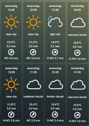

I'm migrating v2 to v3
The old version was a block which automatically wrapped to next line looked like following
the new weather block does not do the wrap
an seperate block in the second line would have to display the weather data with a time shift

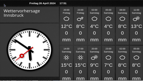

I see the wrapping of a weather block is not supported at the moment.
I'll look into how this can be added again.

Try latest beta.
Update with 'git pull' on the beta branch.
You can add the block parameter `rows: 2` to display the weather forecast on two rows.
Also see:
https://dashticz.readthedocs.io/en/beta ... tiple-rows
