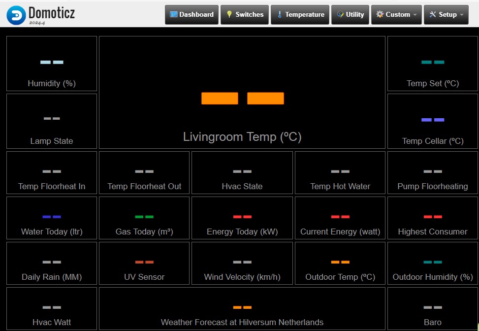

HansieNL
Posts: 969
Re: switch tab
Post by HansieNL »
Maybe Dashticz is an option?
You can create your own dashboard look and mix different devices on same page.
https://github.com/Dashticz
Blah blah blah

What about a custom menu?
