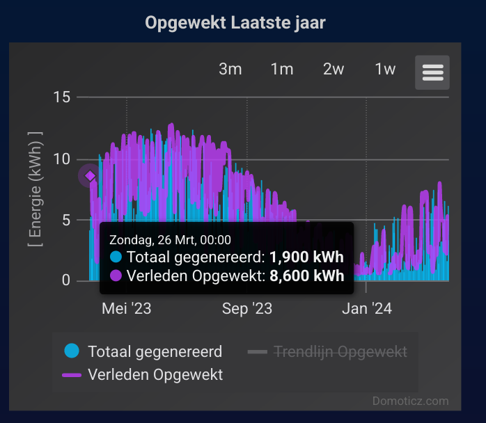

How do you get that graph?
Mine shows Past Usage and Trend Usage with strikethrough text

Found it, so simple. :oops: A mouseover would help.

Kedi wrote: Sunday 24 March 2024 16:25 How do you get that graph?
You can click on the greyed out options to enable them

ricorico94 wrote: Sunday 24 March 2024 16:44 To be honest, I had seen this "total usage" and "past usage" without understanding what it was calculating..
What is this "past usage" ? the usage during previous period (previous year or previous month depending on the graph you look at ?) ? or the sum of several previous periods ? Is it documented somewhere ?
It is what is says. The past years values shows the corresponding value of last year so you can compare it with this year's value.
