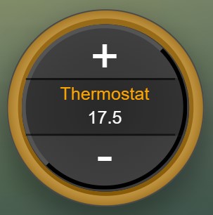

I am trying to create a Dashticz dashboard and I am willing to use the block type: Dial and subType: upDown for my thermostat.
I have defined a block with:
blocks['thermtempupdown'] = {
idx: 71,
title: 'Thermostat',
type: 'dial',
subtype: 'updown',
This block will look like:
I believe it should not have the orange circle but it should be gray.
Also the temperature should appear with "°C" on it.
And finally, the +/- button do nothing.
The same IDX in a standard blocks is working fine.
It is also working fine in a "dial" block that is not "subtype: updown". But I prefer the updown style of block.

You are using the Dashticz beta branch?
It seems something went wrong in one of the recent changes on the beta branch.
Can you try the master branch? That one still should work.
In the mean time I'll analyze the problem in the beta branch.

Fixed in latest beta.

I am indeed setup with the beta version. Sorry that I didn't mention it before.
I made an update of my dashticz and it is indeed working correctly now.
Thanks a lot for the very quick feedback and correction.
