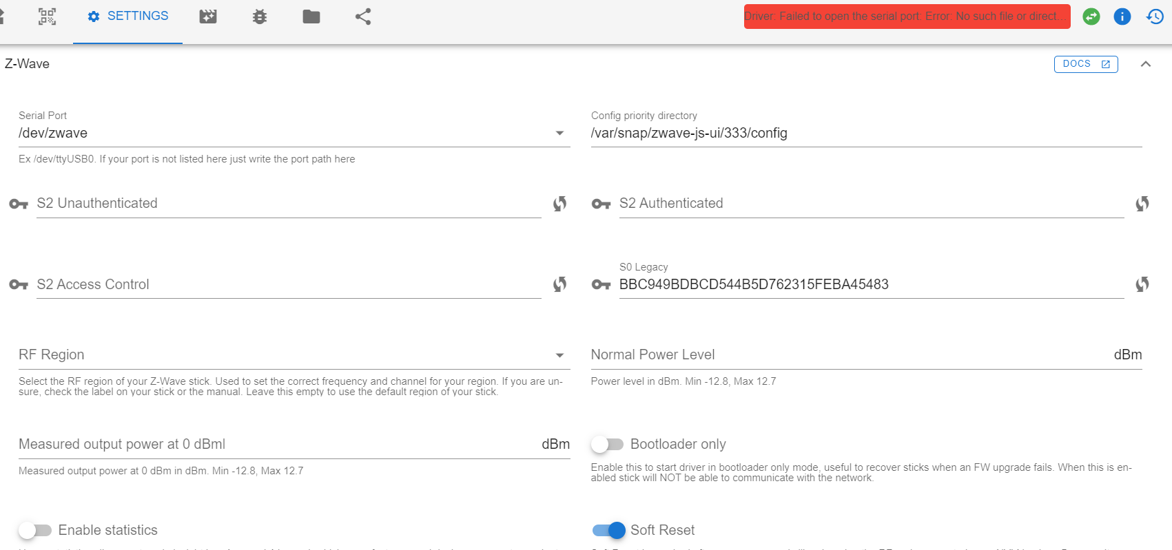

I'm trying to install z-wave-ui with docking and mqtt for more then 3 weeks without an acceptable result.
When I call the zwave-ui page I can make settings but the page is showing an error "Driver: failed to open serial port Error: no such file or directory, cannot open /dev/zwave (zw0100)"
I've read a real lot of internet pages but can't found a solution to solve this.
At one place on the internet I saw this should be a permission problem but I cann't find this page again so also no solution :)
On the other hand, "/dev/zwave (zw0100" is not a known adress for me either

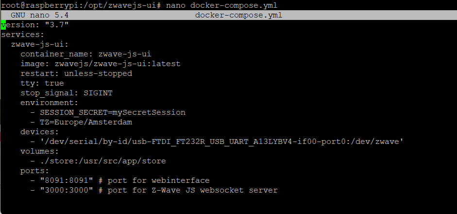

Can you share your docker-compose.yml file or at least the devices section as mentioned here:
https://www.domoticz.com/wiki/Zwave-JS- ... ZWaveJS-UI
Devices section should look something like.
devices:
      - '/dev/serial/by-id/usb-Silicon_Labs_CP2102_USB_to_UART_Bridge_Controller_0001-if00-port0:/dev/zwave'
Also check the USB name on your system with
ls /dev/serial/by-id
You should see one or multiple serial devices, find out which one is your ZWave stick, for example it's:

I Think you want to see this :
ls /dev/serial/by-id result:
usb-0658_0200-if00 usb-FTDI_FT232R_USB_UART_A13LYBV4-if00-port0
http://www.capady.nl/tmp/Scherm_1.png
Schermafbeelding 2024-02-16 141128.png (33.42 KiB) Viewed 695 times

Yes, looks ok if the output of
gives the same output for the USB device you are using.
Do you have more USB devices attached to your system? Are you sure this device is your USB Zwave-stick?

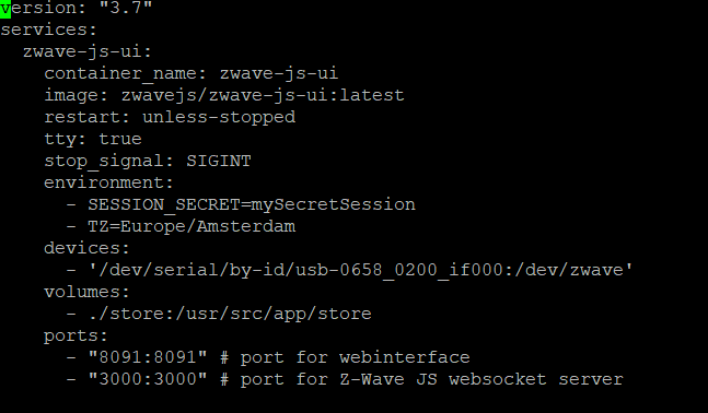

You edited your post. I see that ls /dev/serial/by-id gives 2 results:
usb-0658_0200-if00
Which one is the Zwave Stick?
Googling for both let me think usb-0658_0200-if00 is the Zwave stick so that should be used in the docker-compose.yml

I hadn't even noted there where 2 USB's :(
But I have still the same problem

I see your images. Did you restart the docker container after the change?

I noticed an zero to many in the config file. (_if000 instead of _if00)
I've removed that zero and reboot the raspberry, I suppose docker will be restarted then also

After editing some parameters at MQTT it is up and running without errors.
