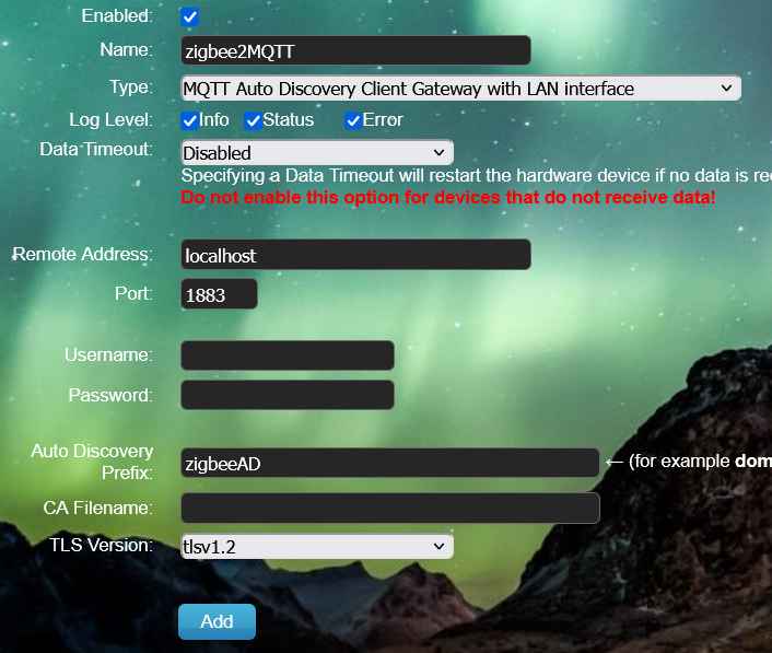

The AD topic is different from the zigbee2mqtt topic:

by Kedi
Why change the defaults?
The defaults are: zigbee2mqtt (for status and activation of swithes and such) and homeassistant (for config of auto-discovery)
I suppose you changed homeassistant to zigbeeAD? In Domoticz this should be the 'Auto Discovery Prefix'

Kedi wrote: Thursday 08 February 2024 14:16 Why change the defaults?
Correct, I have added ZigbeeAD as the prefix in the hardware

Posted: Thursday 08 February 2024 18:44
by Kedi

Here you stated that the topic was zigbee. Did you change the topic in zigbee2mqtt?
The domoticz gives the error: "zigbee2MQTT: Switch not found!? as you stated above might come from the fact that the ID of the device changed. Is it possible to start over again? Leave the discovery topic default ( homeassistant ), clean the topics from the mosquitto server and then delete the MQTT-AD hardware and start over the discovery with new hardware (homeassistant).

Kedi wrote: Thursday 08 February 2024 18:44 Here you stated that the topic was zigbee. Did you change the topic in zigbee2mqtt?
Yes, I changed the zigbee to zigbeeAD, but that changed nothing.
As per your advices, i changed to the defaults, the results are the same.
