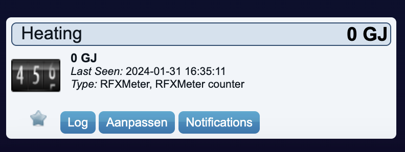

what I have now
IDX 251 is called 'heat_energy' (and gives 210,31GJ)
IDX 263 is my new dummy, zie screenshot
My code (in events, lua, type 'all'):

what I have now

- Schermafbeelding 2024-01-31 om 16.45.30.png (52.91 KiB) Viewed 7868 times
