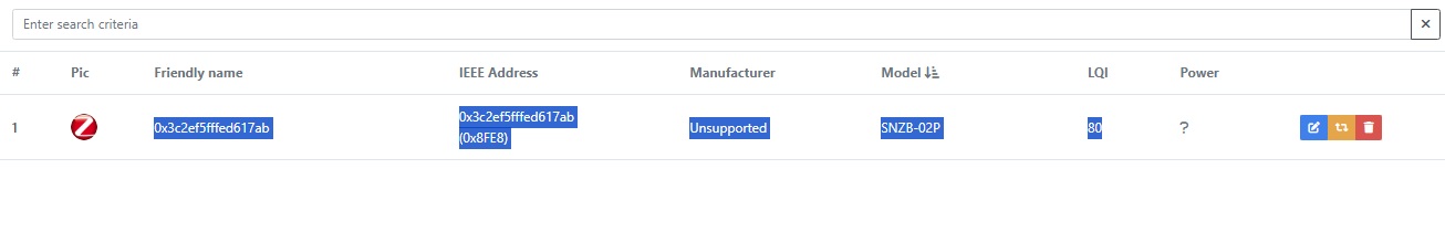

I'm trying to add 2 SNZB-02P sensors and I can't. do you have any idea if they are compatible or is it another problem for me?
It appears on the Zigbee2MQTT page but with Unsupported but I don't see them in domoticz in the device.
- domoticz.jpg (35.11 KiB) Viewed 2644 times

Defintely supported by z2m, see here:
https://zigbee.blakadder.com/Sonoff_SNZB-02P.html
What version of z2m are you on ?

I notice, but I can't add them
I tried with 2 different sensors

Z2M version ?

Zigbee2MQTT Plugin (v. 3.2.0-beta)

Maybe a post on the z2m github support page will help, I don't have any of those sensors but someone else may have the same issue. Also I use MQTT auto detect instead of the zigbee plugin but i doubt that would change the lack of detection. If the device isn't understood by domoticz it wont appear (as far as I know)

after update plugin: v.3.2.0-beta, zigbee2mqtt: v.1.29.2 to plugin: v.3.2.0-beta, zigbee2mqtt: v.1.35.2 it's working.
