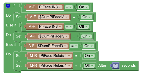

I found that when when assigning pin_type=rising to a PiFace input it acts as a toggle (first push on, second push off), and that every push is registered without any delay by the PiFace/RasPi.
So, you could trigger in domoticz on every rise and fall of the PiFace Input.
In Blocky Events I used this (Note that the dummy Switch has set a delayed-off time of 1 sec) :
Schermafbeelding 2015-05-12 om 22.37.00.png (57.88 KiB) Viewed 11834 times
In this way DumPiFaceI3 is set to ON on every rise and fall of PiFace IN3 (i.e. your doorbell Pushbutton connected to Input3 of the Piface), and switches to Off after 1 sec.
Then when the Dummy is ON, I set a PiFace Relay to ON, and switch it Off after 4 secs.
Instead of A PiFace Relay you could use anything else.

I already built in a timer in the script but didnt work. I now know why. When the doorbell is pressed it sometimes is 1 - 3 seconds before Domoticz registered it.
After Domoticz/script got the first pressed doorbell button registered the timer works fine.
The question is now why the input of the piface is not faster registrated on the piface. Maybe I have to only zwave products.
