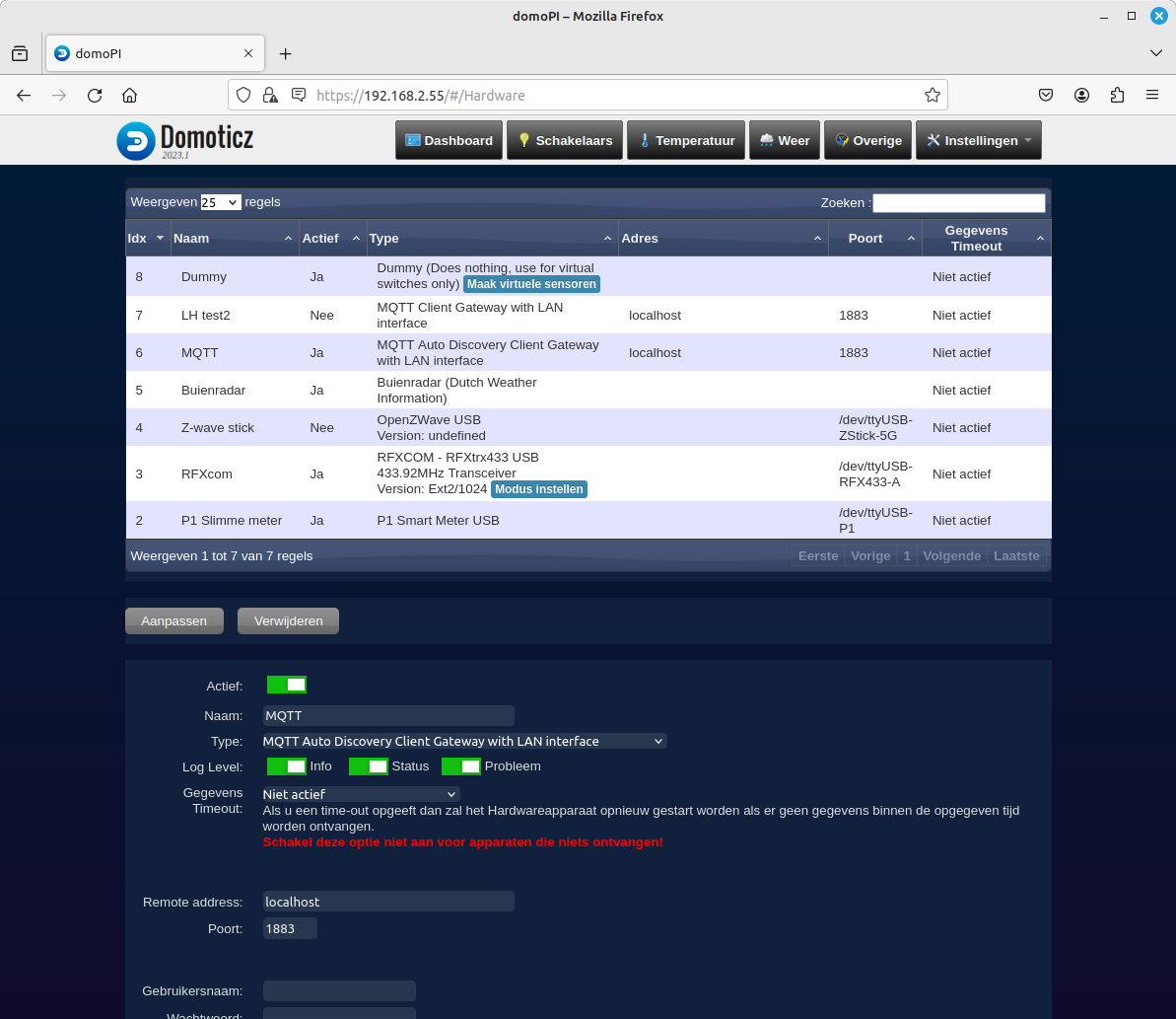

Now in Domoticz:
Disable OZW
Enable the autodiscovery.
Nothing happens! The setup button like there is in OZW does not come up.

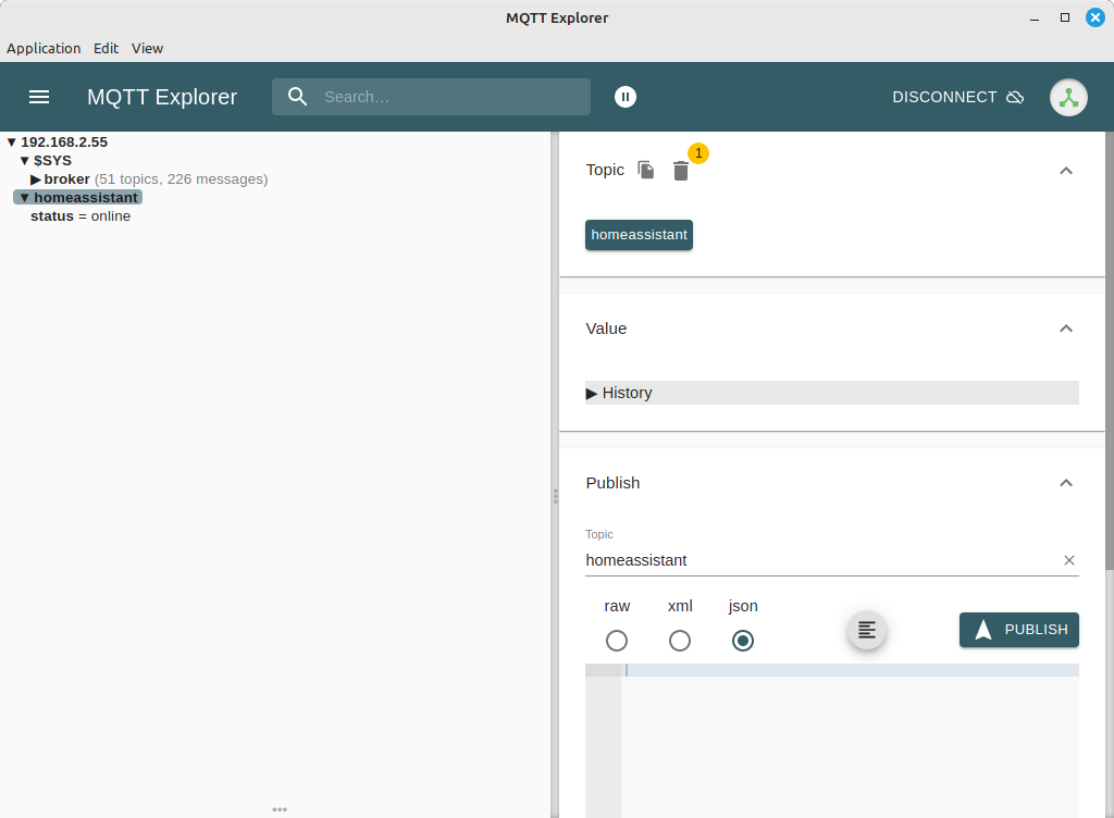

With full debug logging to file of domoticz I see only four lines:
Debug: : MQTT PublishSchema 0 (0), Retain 0
Status: MQTT: Connecting to localhost:1883
Status: MQTT: connected to: localhost:1883
Debug: MQTT: Topic: homeassistant/status, Message: online
In MQTT Explorer the topic homeassistant/status = online appear.
For the rest: nothing at all.

In remote address on the hardware tab use the actual IP instead of localhost.

I mean in mqtt explorer screenshot there is a homeassistant folder.
In your case it shows only status but it should show much more when devices are being published by Zwave-JS-UI

Re: Zwavejs-UI working in Control panel, but NOT in Domoticz with auto discovery
The pi is on an other location so i can not use the mqtt-explorer at the moment, but i made a screenprint from the hardware setting.
MQTT AD is active. Yesterday i was on location and i remembered seeing that output.
By the way: Do you know if there is a possibility to see mqtt output like in explorer via the console in putty. (My VNC-viewer gets a timeout from the server, although I restarted it via putty)
thanks
thanks

- Posts: 7024
- Domoticz version: 2026.3
You can install MQTT Explorer on any system in your network. No need to install it on your Domoticz server.
Also check your logs for errors. To be sure: It is completely normal that the Settings button shows no devices as that has a different meaning with MQTT AD in contrary to OpenZwave (OZW)
So check your default device list (menu Setup - Devices ) for new discovered devices.,
