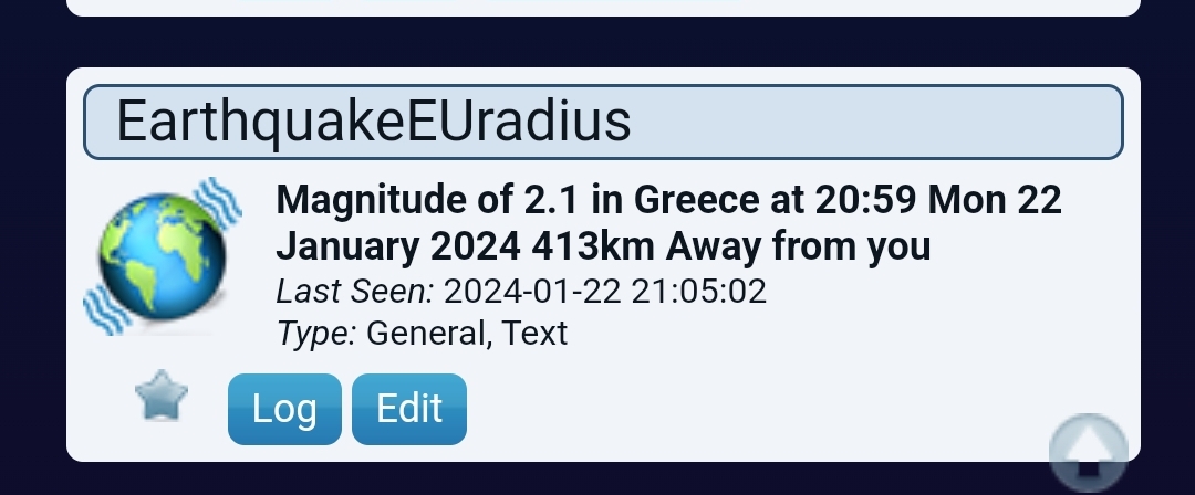

more detailed information on telegram about the earthquake
-- This script was created by mojso
-- https://github.com/mojso/Domoticz_scripts
--this scripts gets earthquake info from www.seismicportal.eu for a defined area and then updates a text sensor with Magnitude and location
--it takes the first entry (= the most recent one) and therefore runs every 5 minutes
		timer = { 'every 5 minutes'},
		httpResponses = { 'kwakeV4' } -- matches callback string below
	execute = function(domoticz, triggerItem)
-----Adjust these variables to get information about the place you want
local yourLatitude = xx.xxxx
local yourLongitude = xx.xxxx
local radiusq = 700  --radius for how far you want to receive information
local minmagq = 1
local yourlocaltime = 3600  -- your local time 3600 equal +1 UTC time
function titleCase( first, rest )
   return first:upper()..rest:lower()
local sensor = domoticz.devices('EarthquakeDevice')
local currInfo = tostring(sensor.text)
		if (triggerItem.isTimer) then
			domoticz.openURL({
				url = 'www.seismicportal.eu/fdsnws/event/1/query?limit=10&lat='..yourLatitude..'&lon='..yourLongitude..'&minradius=0.1&maxradius=180&format=json&minmag='..minmagq..'',
				method = 'GET',
				callback = 'kwakeV4'
		elseif (triggerItem.isHTTPResponse) then
	local response = triggerItem
		if (response.ok and response.isJSON) then
				local mgt = tonumber(response.json.features[1].properties.mag)
				local lugar = tostring(response.json.features[1].properties.flynn_region)
				local timestampString = tostring(response.json.features[1].properties.time)
				local latq = tonumber(response.json.features[1].properties.lat)
				local lonq = tonumber(response.json.features[1].properties.lon)
				local depthq = tonumber(response.json.features[1].properties.depth)
				--local t = string.sub(cuando, 1,10)
				local t = os.time{year=tonumber(timestampString:sub(1,4)),
                                   month=tonumber(timestampString:sub(6,7)),
                                   day=tonumber(timestampString:sub(9,10)),
                                   hour=tonumber(timestampString:sub(12,13)),
                                   min=tonumber(timestampString:sub(15,16)),
                                   sec=tonumber(timestampString:sub(18,19))}
		                local reString = os.date('%H:%M %a %d %B %Y', t + yourlocaltime)
				        local reStringUTC = os.date('%H:%M %a %d %B %Y', t)
				lugar = string.gsub(lugar, "(%a)([%w_']*)", titleCase)
							-- Calculate distance using Haversine formula
        local function calculateDistance(lat1, lon1, lat2, lon2)
            local R = 6371 -- Earth radius in kilometers
            local dLat = math.rad(lat2 - lat1)
            local dLon = math.rad(lon2 - lon1)
            local a = math.sin(dLat / 2) * math.sin(dLat / 2) + math.cos(math.rad(lat1)) * math.cos(math.rad(lat2)) * math.sin(dLon / 2) * math.sin(dLon / 2)
            local c = 2 * math.atan2(math.sqrt(a), math.sqrt(1 - a))
            local distance = R * c
            return distance
        local distance = calculateDistance(yourLatitude, yourLongitude, latq, lonq)
-- Round the distance to the nearest kilometer
        local roundedDistance = math.floor(distance + 0.5)
              local qInfo = tostring('Magnitude of '.. mgt.. ' in '..lugar.. ' at '..reString.. ' '  .. roundedDistance ..'km Away from you')

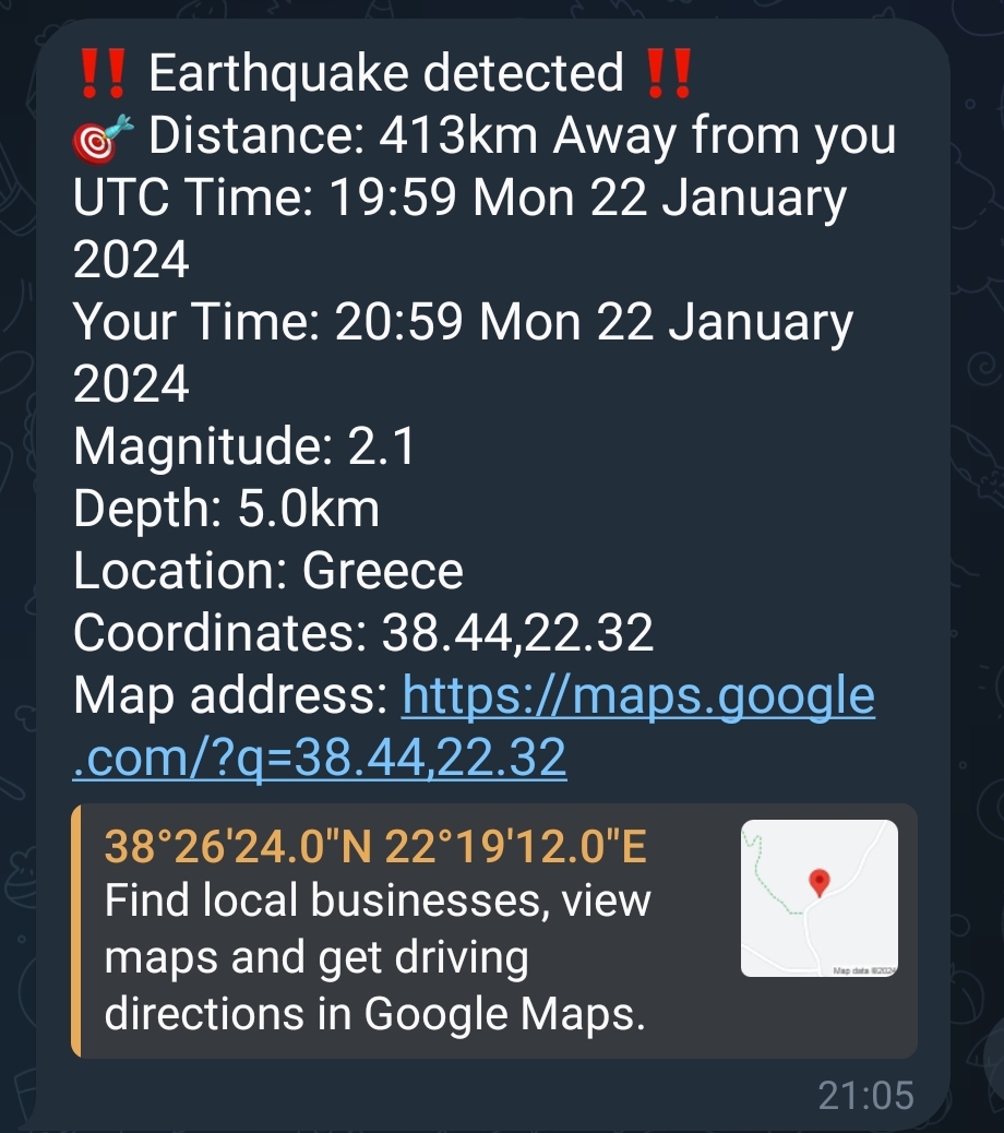

						local message = tostring(" ‼ Earthquake detected ‼ \n" ..
						            "🎯 Distance: " .. roundedDistance .. "km Away from you\n" ..
						            "UTC Time: " ..reStringUTC.. "\n" ..
						            "Your Time: " ..reString.. "\n" ..
                                    "Magnitude: " .. mgt .. "\n" ..
                                    "Depth: " .. depthq .. "km \n" ..
                                    "Location: " .. lugar .. "\n" ..
                                    "Coordinates: " .. latq .. ",".. lonq .. "\n" ..
                                    "Map address: https://maps.google.com/?q="..latq..","..lonq)
                                    if qInfo ~= currInfo and  roundedDistance < radiusq then
    						sensor.updateText(qInfo)
    						-- if you don't want to receive notifications, put -- at the beginning of the row below
    						domoticz.notify('qInfo', message , domoticz.PRIORITY_NORMAL,nil,nil,domoticz.NSS_TELEGRAM)
                            --domoticz.notify('qInfo', qInfo , domoticz.PRIORITY_NORMAL,nil,nil,domoticz.NSS_HTTP)
				print('**kwake failed to fetch info')
Last edited by mojso on Saturday 14 September 2024 21:19, edited 4 times in total.

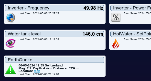

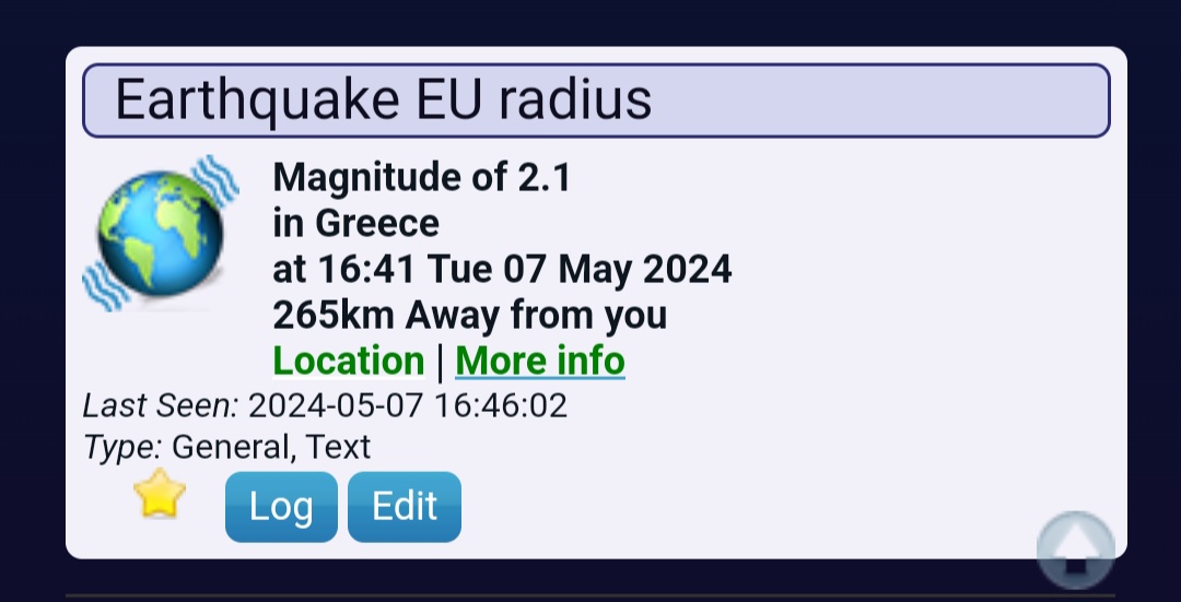

It inspired me to adapt it to my personal situation, for which I made a number of changes and additions.
I still have to see if you can also limit the search area in the query to a desired radius around your own location.
For now:
-- Make use of alert device in stead of text device. (create that first and then use the idx.)
-- Get your own coordinates from the Domoticz settings
-- Set alert color based on configurable distance ranges.
I use 0-250 km = RED; 250-500 km = ORANGE; 500-750 km = YELLOW; 750-max distance set = GREY
-- Translated and reordered the content.
-- Reordered date format in atLocalTime and atUTCtime
-- Reordered info in alertText and email.
-- Added links to source and map also in the device.
-- Changed notification to email and set a mailto
-- Changed naming of some variables attempt to a more consistent naming.
It looks like this:
-- Original script from User mojso: see https://www.domoticz.com/forum/viewtopic.php?t=41380
-- This scripts gets earthquake info from www.seismicportal.eu for a defined area
-- Then updates dummy sensor with Time, Location, Magnitude, Depth, Distance
-- It takes the first entry (= the most recent one) and therefore runs every 5 minutes.
-- 21-03-2024 Version with some modifications by Jan Peppink, https://ict.peppink.nl
--	Set alert color based on configurable distance.
--	Reordered info in alertText.
		timer = { 'every 2 minutes' },
		httpResponses = { 'qResponse' }   -- matches callback string below
		-- Set to your environment and preference
		local mailto = '[email protected]'     -- Set E-mail adres to sent to.
	       local alertIdx = n		-- Set to the idx of the Virtual Alert sensor you have to create for this script
        	local qRadius = 1000		-- Set the radius for how far you want to receive information
		-- Set your loccation coordinates from Domoticz settings =================
		local yourLatitude = domoticz.settings.location.latitude
		local yourLongitude = domoticz.settings.location.longitude
		local alertLevel = domoticz.ALERTLEVEL_GREY -- Holds the alertLevel (color) to set
		local alertText = ''
		local lastalertText = domoticz.devices(alertIdx).text	-- Holds string of the previous round.
		local qMinmag = 1
		local lTimediff = 3600  -- your local time 3600 equal +1 UTC time
		-- Define distance for ALERTLEVEL colors
		-- From dClose to radiusq ALERTLEVEL_GREY
		local dClose = 750          -- From distance dCloser to dClose ALERTLEVEL_YELLOW
		local dCloser = 500         -- From distance dClosest to dCloser ALERTLEVEL_ORANGE
		local dClosest = 250        -- From distance 0 to closest ALERTLEVEL_RED
	        -- Local Functions go here =============
			return distance
		-- Now start to do something ============
			domoticz.openURL({
				url = 'www.seismicportal.eu/fdsnws/event/1/query?limit=10&lat='..yourLatitude..'&lon='..yourLongitude..'&minradius=0&maxradius=180&format=json&minmag='..qMinmag..'',
				method = 'GET',
				callback = 'qResponse'
			    -- We have something.
				local qMag = tonumber(response.json.features[1].properties.mag)
				local qRegion = tostring(response.json.features[1].properties.flynn_region)
				local qTimeString = tostring(response.json.features[1].properties.time)
				local qLat = tonumber(response.json.features[1].properties.lat)
				local qLon = tonumber(response.json.features[1].properties.lon)
				local qDepth = tonumber(response.json.features[1].properties.depth)
				local t = os.time{year=tonumber(qTimeString:sub(1,4)),
					month=tonumber(qTimeString:sub(6,7)),
					day=tonumber(qTimeString:sub(9,10)),
					hour=tonumber(qTimeString:sub(12,13)),
					min=tonumber(qTimeString:sub(15,16)),
					sec=tonumber(qTimeString:sub(18,19))}
				-- local atLocalTime = os.date('%H:%M %a %d %B %Y', t + lTimediff)
				-- local atUTCtime = os.date('%H:%M %a %d %B %Y', t)
				local atLocalTime = os.date('%d-%m-%Y %H:%M ', t + lTimediff)
				local atUTCtime = os.date('%d-%m-%Y %H:%M ', t)
				-- %d-%m-%Y  %H:%M
				qRegion = string.gsub(qRegion, "(%a)([%w_']*)", titleCase)
				local distance = calculateDistance(yourLatitude, yourLongitude, qLat, qLon)
                --Set Alertlevel color based on distance.
				if roundedDistance < dClosest then
				    alertLevel = domoticz.ALERTLEVEL_RED
				elseif roundedDistance >= dClosest and roundedDistance < dCloser then
                    alertLevel = domoticz.ALERTLEVEL_ORANGE
                elseif roundedDistance >= dCloser and roundedDistance < dClose then
                    alertLevel = domoticz.ALERTLEVEL_YELLOW
                --Set and format the new alertText
				local alertText = tostring(  atLocalTime .. ' uur in ' .. qRegion .. '\n' .. 'Magnitude: ' .. qMag .. '. Diepte: ' .. qDepth .. ' km. Afstand: ' .. roundedDistance ..' km.\n' .. '<a href="https://maps.google.com/?q=' .. qLat .. ',' .. qLon .. '" target="_blank">Toon locatie</a>' .. ' - ' .. '<a href="https://www.seismicportal.eu/" target="_blank">Toon bron</a>')
                --Set and format the new mail message

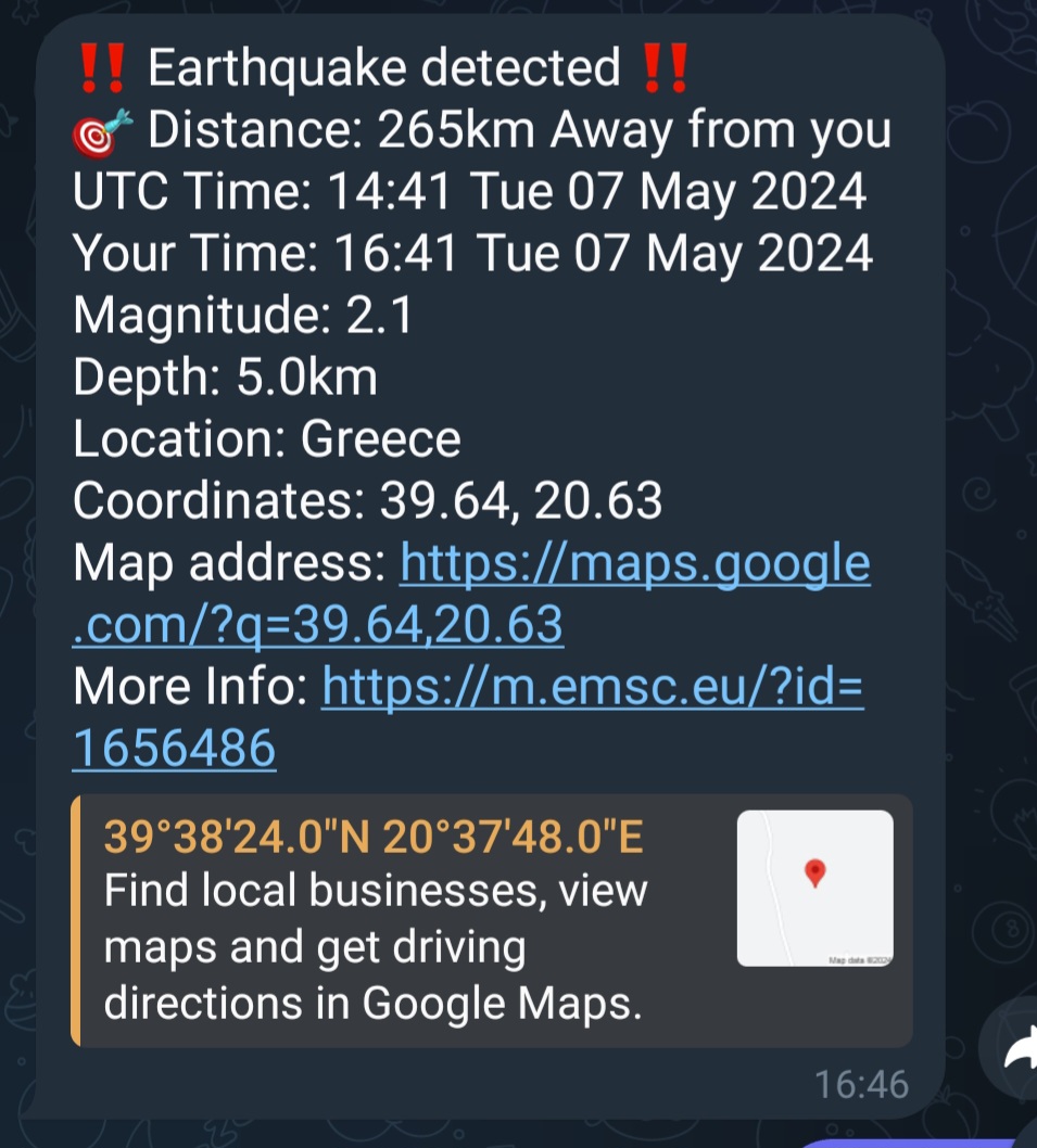

				local message = tostring('Locatie       : ' .. qRegion .. '<br>' ..
					'Magnitude: ' .. qMag .. '<br>' ..
					'Diepte: ' .. qDepth .. 'km<br>' ..
					'UTC Tijd: ' .. atUTCtime .. '<br>' ..
					'Lokale Tijd: ' .. atLocalTime .. '<br>' ..
					'🎯 Afstand: ' .. roundedDistance .. 'km.<br>'..
					'Coordinaten: ' .. qLat .. ','.. qLon .. '<br>' ..
					'<a href="https://maps.google.com/?q=' .. qLat .. ',' .. qLon .. '">Toon locatie</a>' .. '<br>' ..
					'<a href="https://www.seismicportal.eu/">Toon bron</a>' .. '<br>')
                -- Only update and sent message when info has changed. and
				if alertText ~= lastalertText and roundedDistance < qRadius then

I am curious about your experiences with https://www.seismicportal.eu/ I noticed that earthquakes have now occurred in the Netherlands that were not on the list.
I then looked at the API on USGS. See: https://earthquake.usgs.gov/fdsnws/event/1/
I experienced the same thing here!
I don't necessarily need to know about every earthquake anywhere in the world. I am mainly concerned with earthquakes in the Netherlands and the immediate surroundings, so I started searching further and came across the RSS feed of the KNMI. See: https://cdn.knmi.nl/knmi/map/page/seism ... MI_RSS.xml
I have now decided to rebuild the script and parse the XML from this RSS feed.
I kept the same procedure and check every 5 minutes for the latest one listed and only update if there is new information.

This is my second version of my script.
		timer = { 'every 2 minutes'},
local radiusq = 300  --radius for how far you want to receive information
local radiusq2 = 700 -- second radius
local minmagq = 1 --min magnitude for first radius
local minmagq2 = 4.2 -- min magnitude for second radius
local yourlocaltime = 7200  -- your local time 3600 equal +1 UTC time
local minmagworld = 6.5 --minimum earthquake magnitude for the whole world
local sensor = domoticz.devices('Earthquake EU radius')
			domoticz.openURL({
				method = 'GET',
				local qid = tonumber(response.json.features[1].properties.source_id)
            return distance
        local mapurl = '<a href="https://maps.google.com/?q='..latq..','..lonq..'"><font color="green">Location</font></a>'
        local moreinfo = '<a href="https://m.emsc.eu/?id='..qid..'"><font color="green">More info</font></a>'
              local qInfo = tostring('Magnitude of '.. mgt.. '<br> in '..lugar.. '<br> at '..reString.. '<br>'  .. roundedDistance ..'km Away from you <br>'.. mapurl .. ' | ' .. moreinfo)
                                    "Coordinates: " .. latq .. ", ".. lonq .. "\n" ..
                                    "Map address: https://maps.google.com/?q="..latq..","..lonq.. "\n" ..
                                     "More Info: https://m.emsc.eu/?id="..qid)
         -- Message to Kodi
            local mesageKodi = tostring('Magnitude of '.. mgt.. ' in '..lugar.. ' at '..reString.. ' , '  .. roundedDistance ..'km Away from you ')
                                    if qInfo ~= currInfo and  roundedDistance < radiusq or qInfo ~= currInfo and mgt >= minmagworld or qInfo ~= currInfo and  roundedDistance > radiusq  and roundedDistance < radiusq2 and mgt > minmagq2 then
                            domoticz.notify('qInfo', mesageKodi , domoticz.PRIORITY_NORMAL,nil,nil,domoticz.NSS_KODI)
