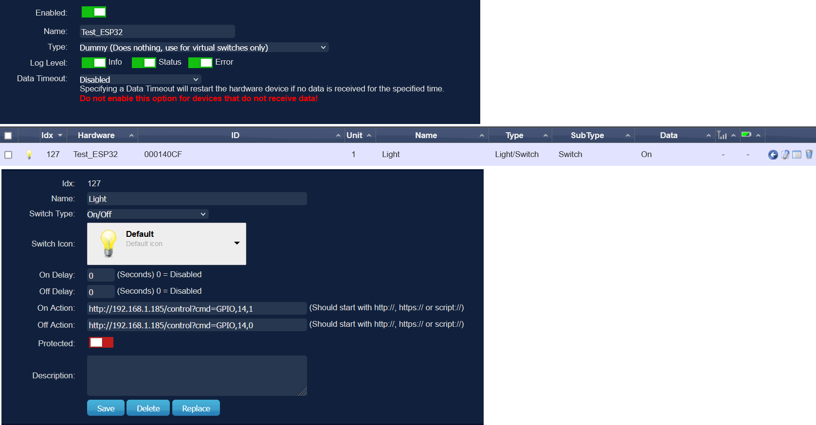

Domoticz:
I created dummy hardware with virtual sensor type: Switch with Idx:127
Inside switch settings I created http request to turn on or off ESP output.

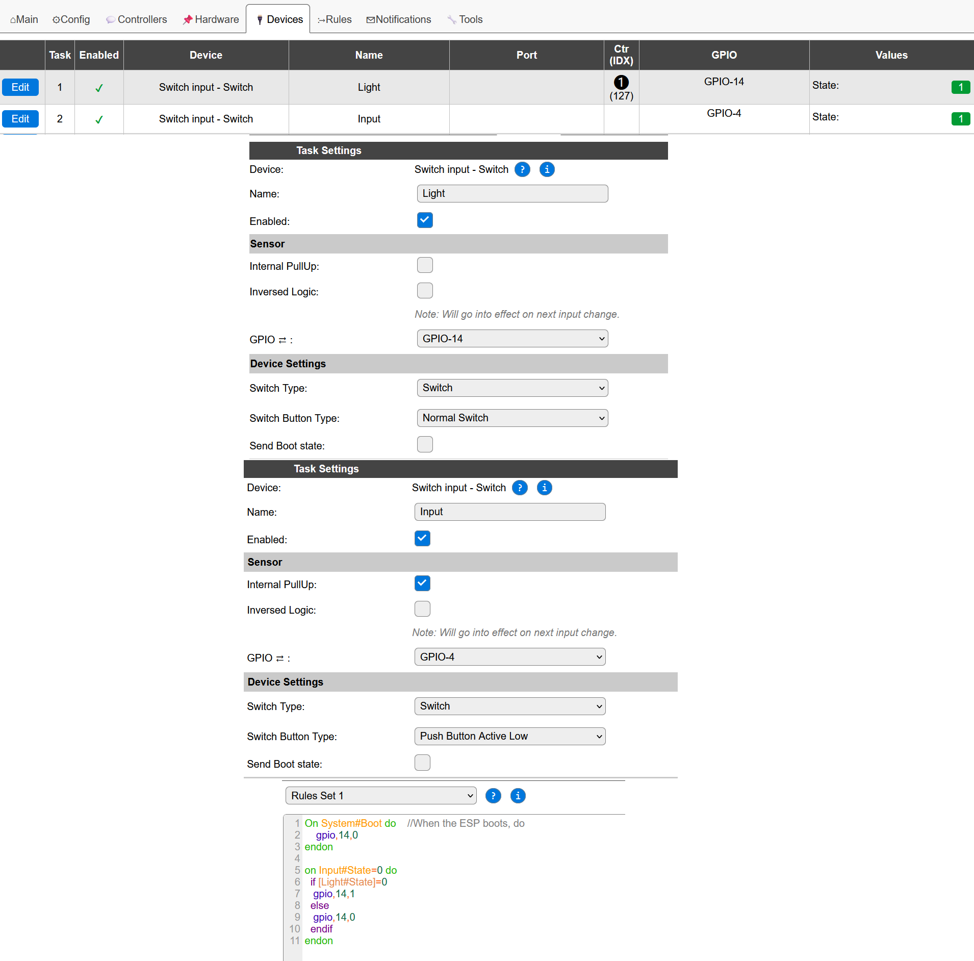

ESP Easy:
I created two devices, one for ESP output with Idx: 127 called "Light" and one for ESP input.
I also make one rule:
On System#Boot do
 gpio,14,0
endon
On Input#State=0 do
 if[Light#State]=0
  gpio,14,1
  gpio,14,0
 endif
endon

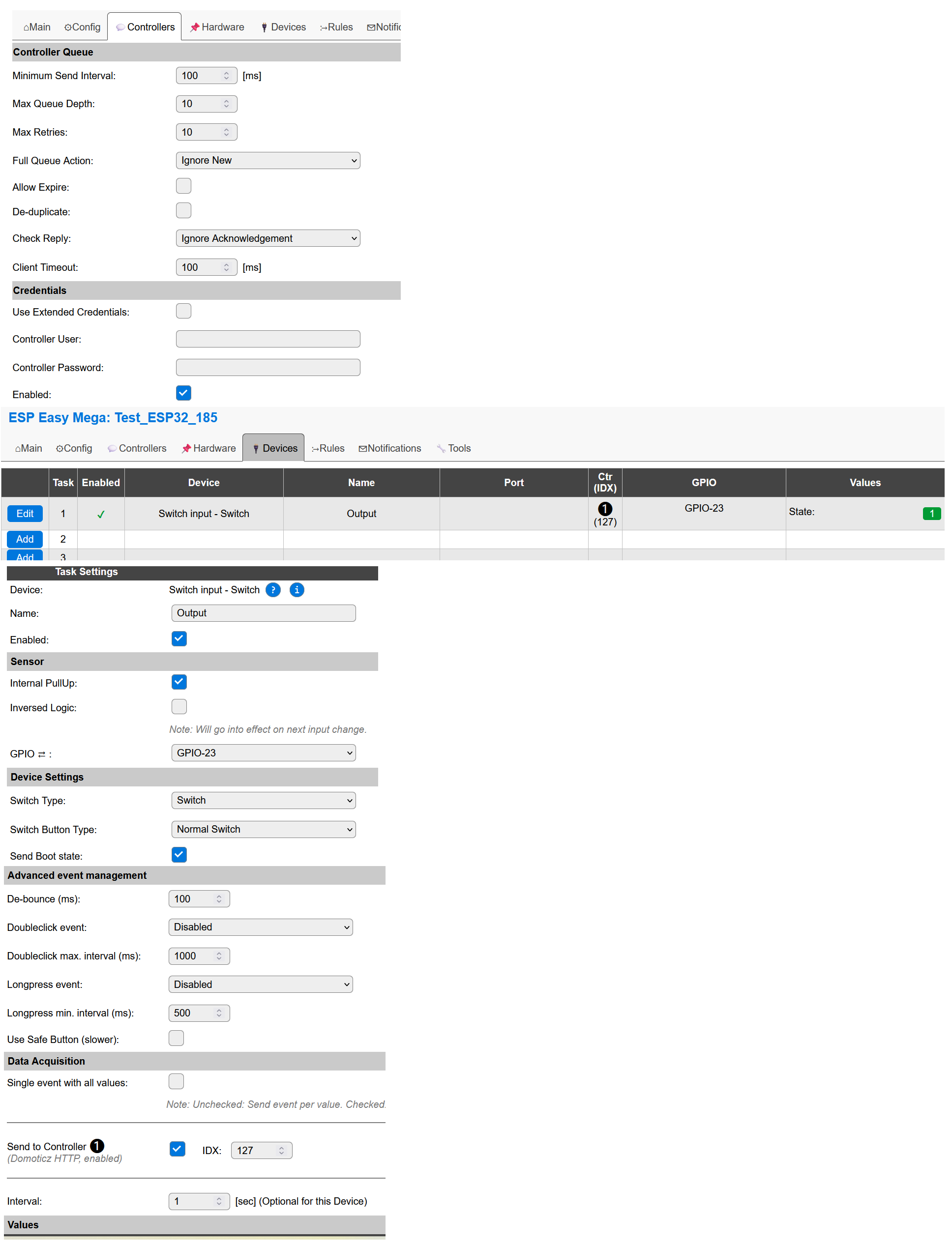

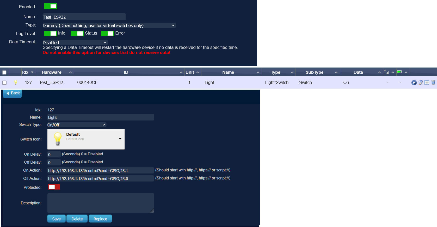

I did a minimal setup now. One device in Domoticz and one device in ESP. No Rules, No PB Switch, External 10k pullup resistor at the output. Please see what is happening with the output when I change the state fast enough.
[youtube]https://youtube.com/shorts/cuNayzz_o9w?feature=share[/youtube]
I noticed it is worst when network is busy. And once again it does not mether I use sonoff, nodemcu, my own design esp8266 or esp32.
One thing that helps a lot is to change "Check Replay:" to 'Check Acknowledgment'.
ESP Settings1.png (203.39 KiB) Viewed 8888 times
Domoticz Settings.png (129.01 KiB) Viewed 8888 times
