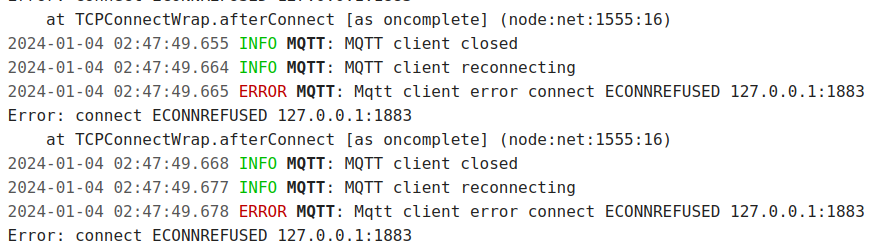

I'm running Domoticz directly on a Ubuntu Linux and have installed the MQTT broker. ZWaveJS-UI is running in Docker on the same machine. I have posted the logs from ZWaveJS-UI if this may help.
My mosquitto conf file has
listener 1883
allow_anonymous true
Screenshot from 2024-01-04 02-50-30.png (93.41 KiB) Viewed 5900 times

Are you sure you used the correct ip in the Zwave JS UI uner Settings MQTT? Use the ip of the server you have the MQTT broker running.

That's correct, don't use 127.0.0.1 or localhost, use the IP address (like 192.168.0.10)
