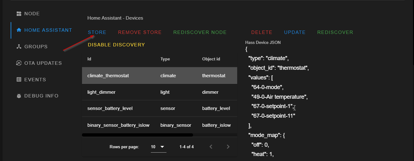

In fact I found that you can store permanently the HASS json by cliking the store button in the menu:
2023-12-10 23_03_11-Z-Wave JS UI.png (40.91 KiB) Viewed 2136 times
This appends the HASS json to the nodes.js file, so it will be not rebuilt at restart.
For multiple instances you can also edit the nodes.js file and copy the HASS json to all instances. Should be simpler than doing with the UI.

Re: OpenZwave to Zwave-JS-UI problems with Eurotronic Spirit and Philio PAT02-1B
Post by toxwa »
waltervl wrote: Wednesday 06 December 2023 23:40 Then you should add that to Zwave-JS-UI GitHub issue, then everybody with this thermostat can benefit from this change.
I was recently looking at their GitHub and found several issues with very similar solutions that are all closed (like this one: https://github.com/zwave-js/zwave-js-ui/issues/1804). The problem is that they are focused mainly on home-assistent and use the climate component. This component has several default options and manufacturer specific and full power are not default options. They always suggest changing the payload manually.
