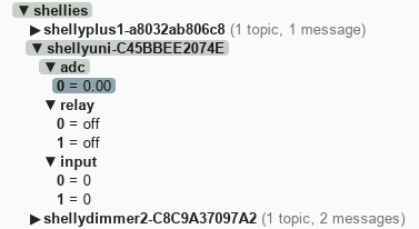

Shelly Uni supports MQTT and as such, you can always interface with it.Does anyone know if shelly uni works in domoticz?
