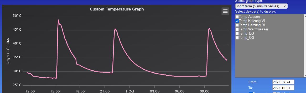

thank you for the reply. I am aware that the time span can be expanded. However, the details get lost and only daily values get visualized. I want to observe events with a periodicity of "some minutes" and "hours". This can be achieved with the short term (5 minutes values) setting.
In Version 2022.2 the time span can be selected up to 7 days and the resolution remains high. This is what I am expecting:
In Version 2023.2 the time span with high resolution is only selectable up to 24h:
Furthermore, the individual setting of the time span longer than one day is not displayed. Here the example from Version 2023.2 with a time span from 2023-09-24 to 2023-10-01. Only last 24 hours are displayes instead of 7 days:
Again: Is it a bug, a feature or just an user operating error from my side?
Is it possible to configure and add presets as 3 and 7 days?
As a workaroud: Is there an easy possibility to export the history data captured over a period of time longer than one day?

I my case I have a 4 days short log (5 min) and in custom graph it will also show these 4 days if the initial time frame is correct.
There is no option on the custom graphs for short cuts for other time frames (3d, 3h, 1h).
So please check your short log setting in menu Setup - Settings.

The setting in the menu was the crucial clue. I think I had used that entry myself a few years ago and had been forgotten.
Thank you very much.
